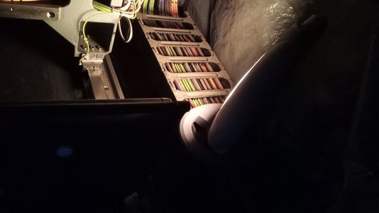

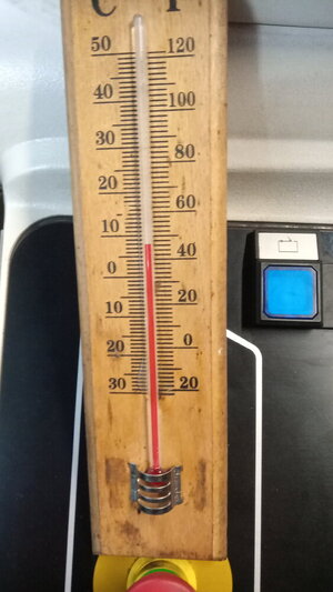

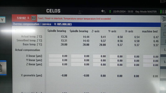

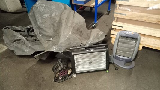

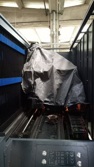

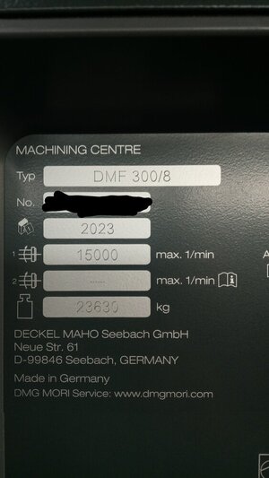

23.6 tons of precision machinery costing some 500k €uro - set up in what could be described as a "chicken coop"!
What could possibly go wrong?
Well, after over 30 days of vacation the machine cooled down below safety tolerances for safe operation and won't run.
The solution , heat it up with household grade electric fan less heaters. :thumbsup:
Yep, almost there!!! 🤣

Aaaaaand she's dead cold again. 🤣
Surrounding workplace temperature is +8°C, the machine requires to have a self temperature of over +10°C.
