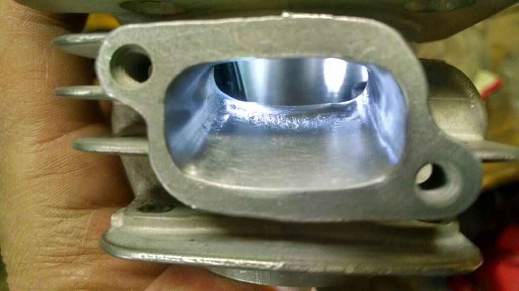

I'm not sure what the deal is with this one. Runs like it's tight and sounds kinda funky.
My NE with the pop up is a gawdamn beast. This one doesn't run terrible but it ain't got balls like the ne. It's also ported different...so part of the learning curve I guess.
Your extension still shrouds the lowers a little. Not sure if that means anything. What are the timing numbers?
I see yours is more open. I'll cut them back some more. Left things down quite low to start. I believe it's at 109/127/78 without checking my notes.

Wow, they like the exhaust that low??? Is it a short stroke engine. I'm trying to get things to make sense to me, Thanks!
32.5mm stroke and yes they like a low exhaust. My other one can be pushed on as hard as you want and keeps eating wood. I prefer a16" .325 bar but it'll pull a 18" 3/8 with authority as well.
