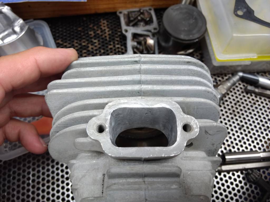

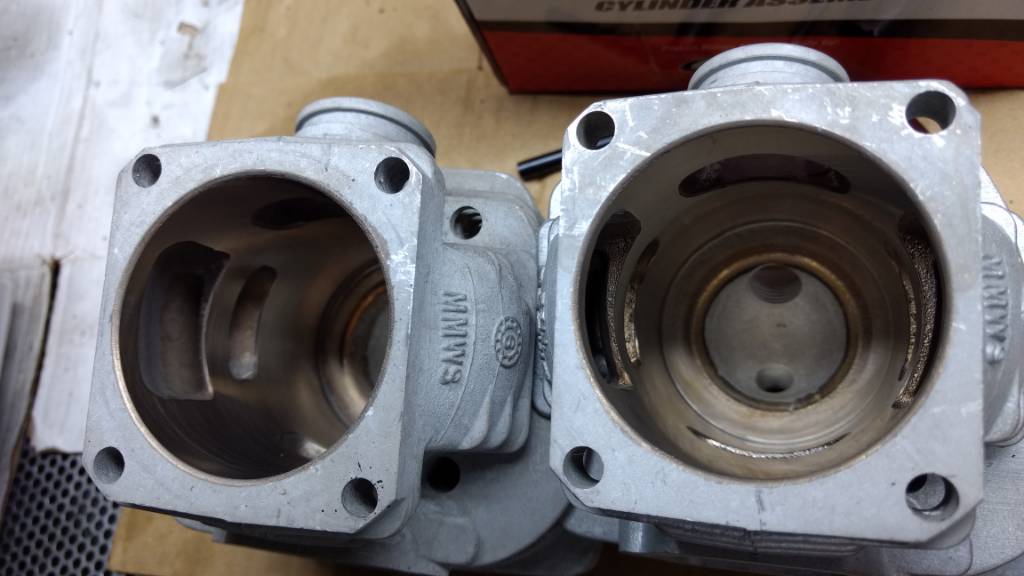

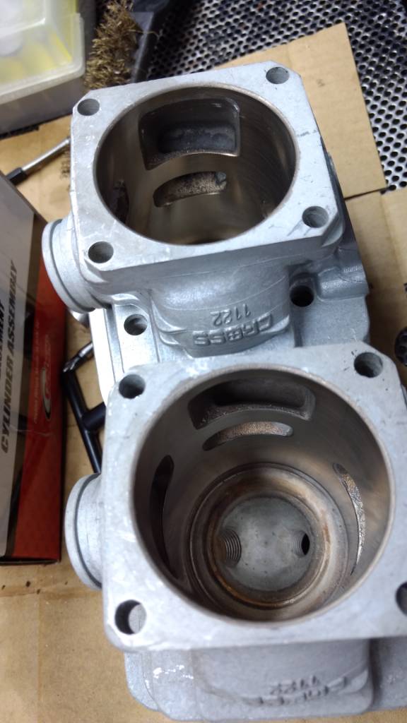

Cross cylinder differences.... One looks really good..... The other is a little on the sloppy side.... For being the "same" cylinder they look quite "different"....
Hard to tell from the pics but color of cyls is different and one casting is very clean and smooth the other has debris and slag throughout the ports...

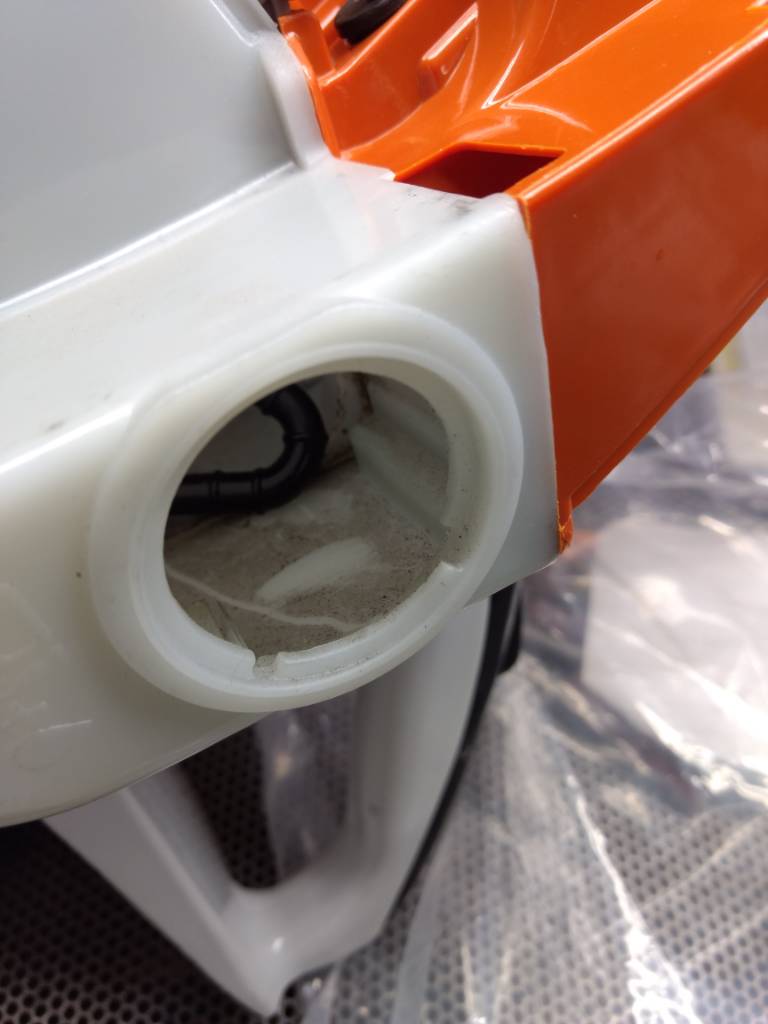

Opened up the fuel tank and found this....
Clean spots are where I smudged it with my finger...
Anybody else find something similar??

Mine was not like that, but Randy did post something about making sure you flush them out.
