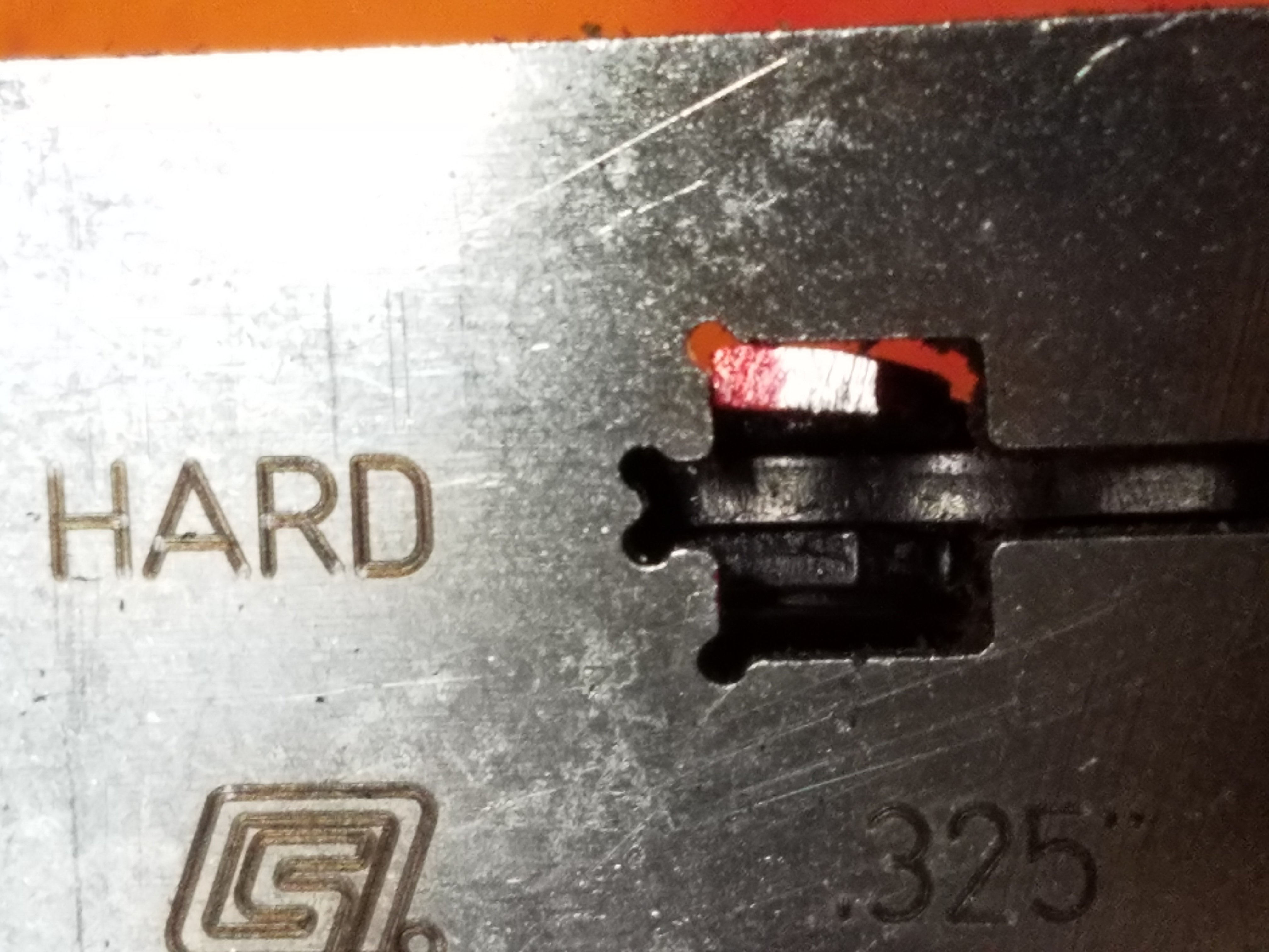

For 325 the Stihl's Hard setting is still definitely more aggressive than Husqvarna's. The picture below shows a raker that was
1. Filed with Husqvarna in the hard setting
2. Marked red
3. Filed (just two swipes) with Stihl in hard setting.
You can see that a lot comes off, and it's a steeper angle - the bottom portion came off first.

I need to spend more time with each, but from first impressions I like the Stihl a lot.
1. It fits on the chain much better than the Husqvarna. The opening on the Husqvarna isn't wide enough for the gauge to stay parallel to the chain, so the bottom never quite sits nicely on the straps. It's also inconsistent whether the position should be based on where the base hits the next cutter or not, because sometimes the raker isn't in the hole when you do that.
2. I always wanted somewhere in between Husqvarna's Hard and Soft setting. Stihl's Hard seems to be exactly this.
I need more time with the stihl, but I think I'm going to like it.
One thing I'm not crazy about is that the markings on the Stihl are going to wear off as you use it. What were they thinking there?

So, are the Stihl gauges made out of hard stainless or just soft mild steel like the Husqvarna gauges?
I have no idea, but I filed a grand total of 3-4 cutters and you can see mine are scratched badly already (in the pics above). I'm not optimistic about how long they'll last.
I have always been reluctant to file hard against any type of depth gauge guide.
If the guide is soft, you will file it away / change the setting. If the guide is hard, you will wear the file teeth unnecessarily.
I typically place the guide, eyeball what needs to be removed, remove the guide, take a few file strokes, re-check, etc.
Replacing the guides is not a big expense, but in this case, they are not easy to obtain.
I thought about the laser etching being filed away, maybe as Philbert says. mark on the underside. Why stihl only marked them where they did. Made me wonder what that dumbfuker disigner didn’t see coming.:rolleyes:
.Also thought about the scratching/filing it thinner.. what about measuring the thickness of the guides. It would give you an idea of the life of the tool
Surely it should take some time before it makes some difference and you got measurements ;)
