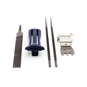

there was an AS member a couple years back who ordered these for others...where I got my current set.

Just order the west coast saws version.

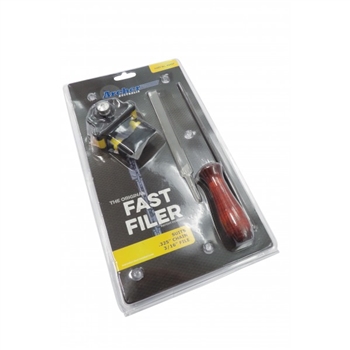

Or get an Archer FastFiler roller filing guide, which is not "progressive" though.

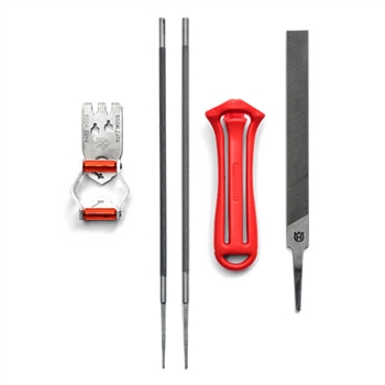

Also, the Husqvarna roller filing guide incorporates a raker depth gauge similar to the Stihl one.

Archer FastFiler, raker roller set is too aggressive on a new chain, too tame on a worn chain.
Works best 1/5th through 3/5th worn cutters, varying depending on used PH and B&C setup.
These are fairly affordable when on sale on HLSupply.
The FastFiler guide is pitch dependant and fits only full complement chain sequence.
Husqvarna roller guide with raker gauge.
Works fine throughout the whole chains life.
The gauge steel is too soft though and a flat file will bite right into it.
This guide set with files is a little bit pricier.
It fits any chain sequence but is pitch dependant.
