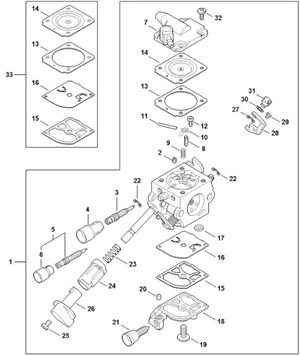

This is a pic I found, it is not the exact BR450 carb, but it is the same style. The pic didn’t come with descriptions, but 14 & 16 are what I was concerned with replacing. Mainly 16, which has the two little flaps that the crankcase pulses cause to pump fuel to the bowl side of the carb. Where is the o-ring located?

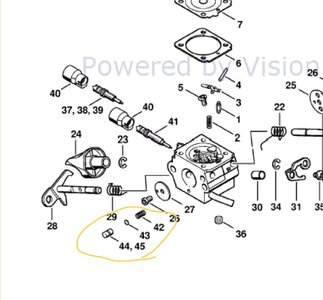

It’s not on that diagram; it’s possible yours doesn’t have it. Stihl uses them fairly randomly. It is in a blind hole drilled above the one mounting hole on the engine side with a spring and a little piston and oring that are moved by a flat spot on the throttle shaft. When the throttle is pulled, it forces extra fuel into the high circuit; therefore, when the oring is bad, it allows air to be pulled into the high side or the metering chamber, depending on the primer setup. This attached photo is from a 550; again, maybe yours doesn’t have it. Most people have no idea this is on many Stihl carburetors.

On the engine side, my carb only has the one hole for the crankcase pulses. I’d love to be able to fix the issue with such a simple method, but no such luck.
