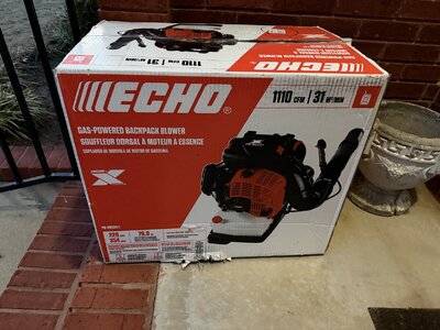

I hope I’ve found the solution to my problem.
Good blower just sucks we couldn’t come up with an answer to the real issue on the Stihl, kinda sucks when a person gets so deep and has to quit. Obviously some issue with it that’s fixable but you have exhausted quite a few of them. Now I wonder if this think is like the ms250 I fixed that had a warped pan and would heat up and start sucking air at the seam. This would probably only be the issue if it’s like a clamshell saw and bolted together around the crank though. I haven’t personally had this model apart so not sure of block design. I did some looking and it does have a pan and transfer covers both potential points of air leaks after it heated up and things moved on the block. Just curious what you sealed the engine back up with after bearing change ect? I realize your done with the 450 but this last question was just for my curiosity. My bad I see you used dirko so that’s good long as pan was flat.
