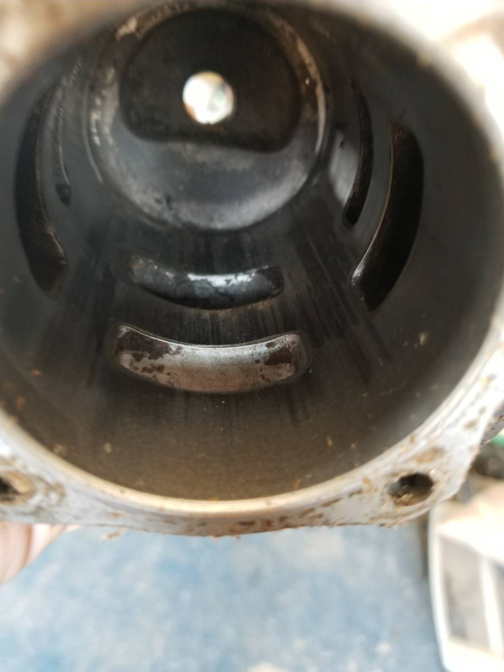

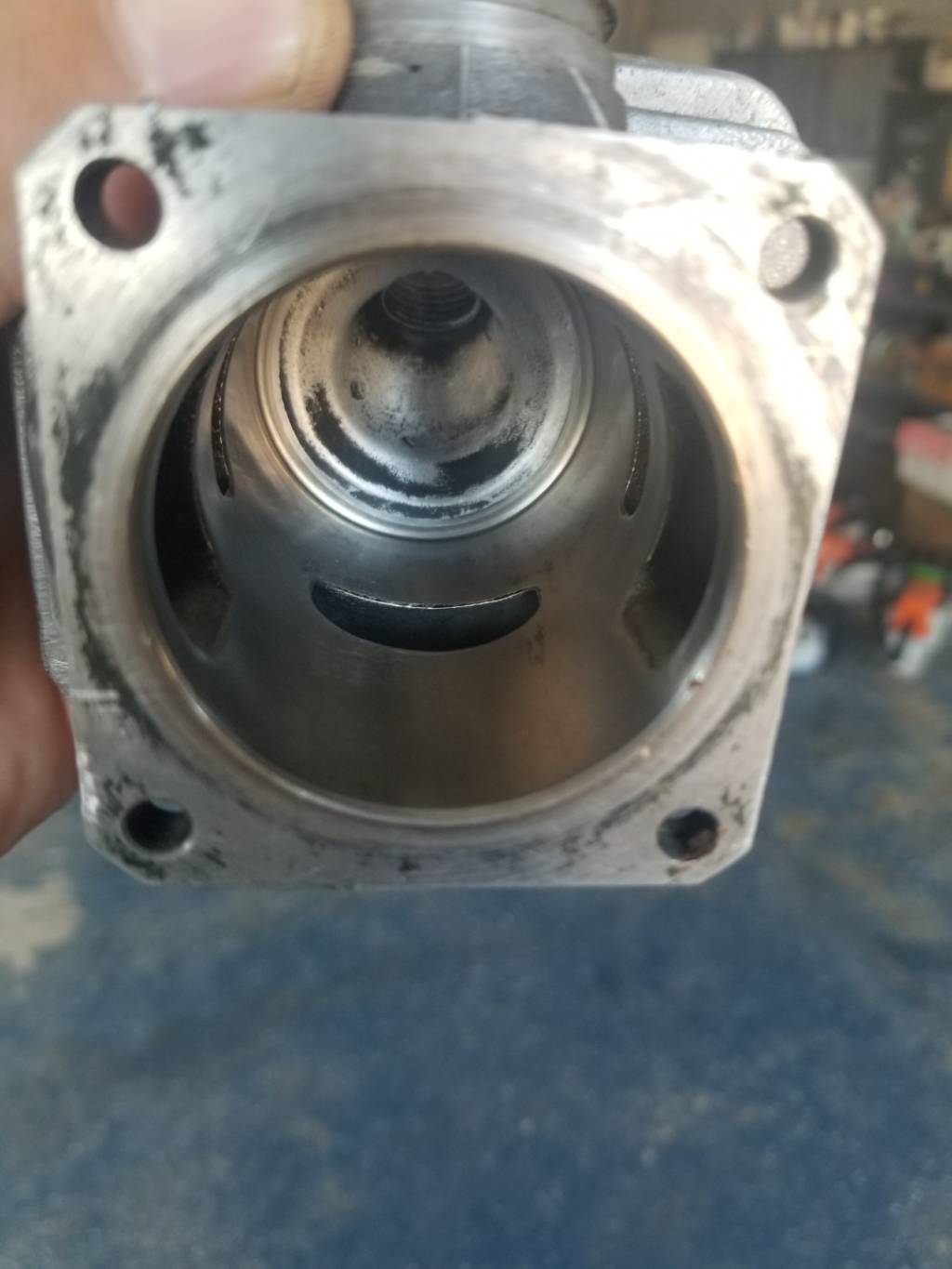

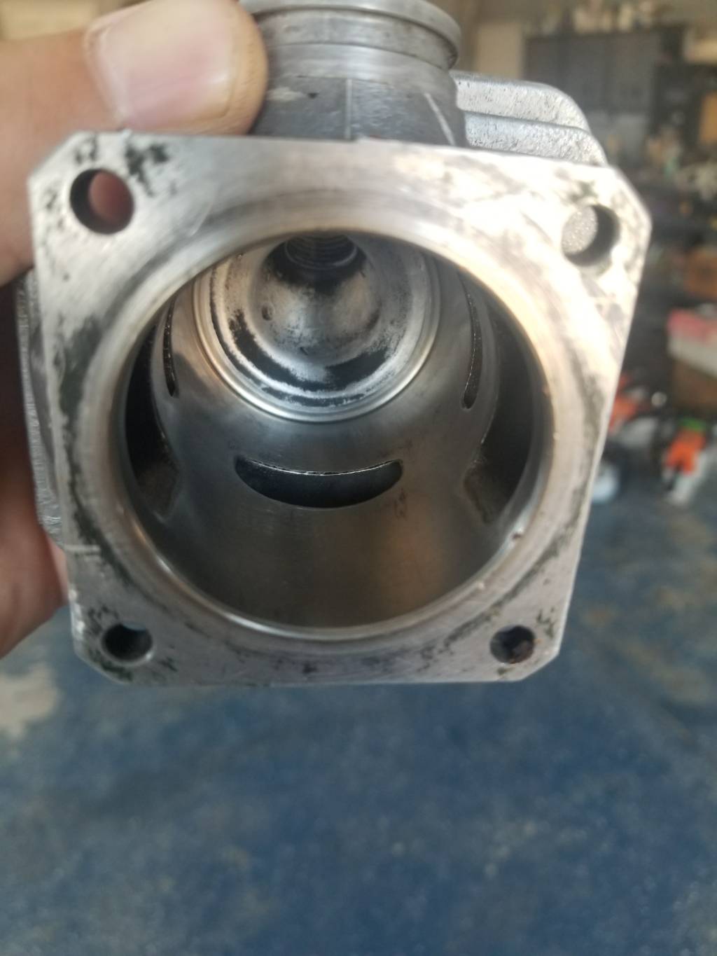

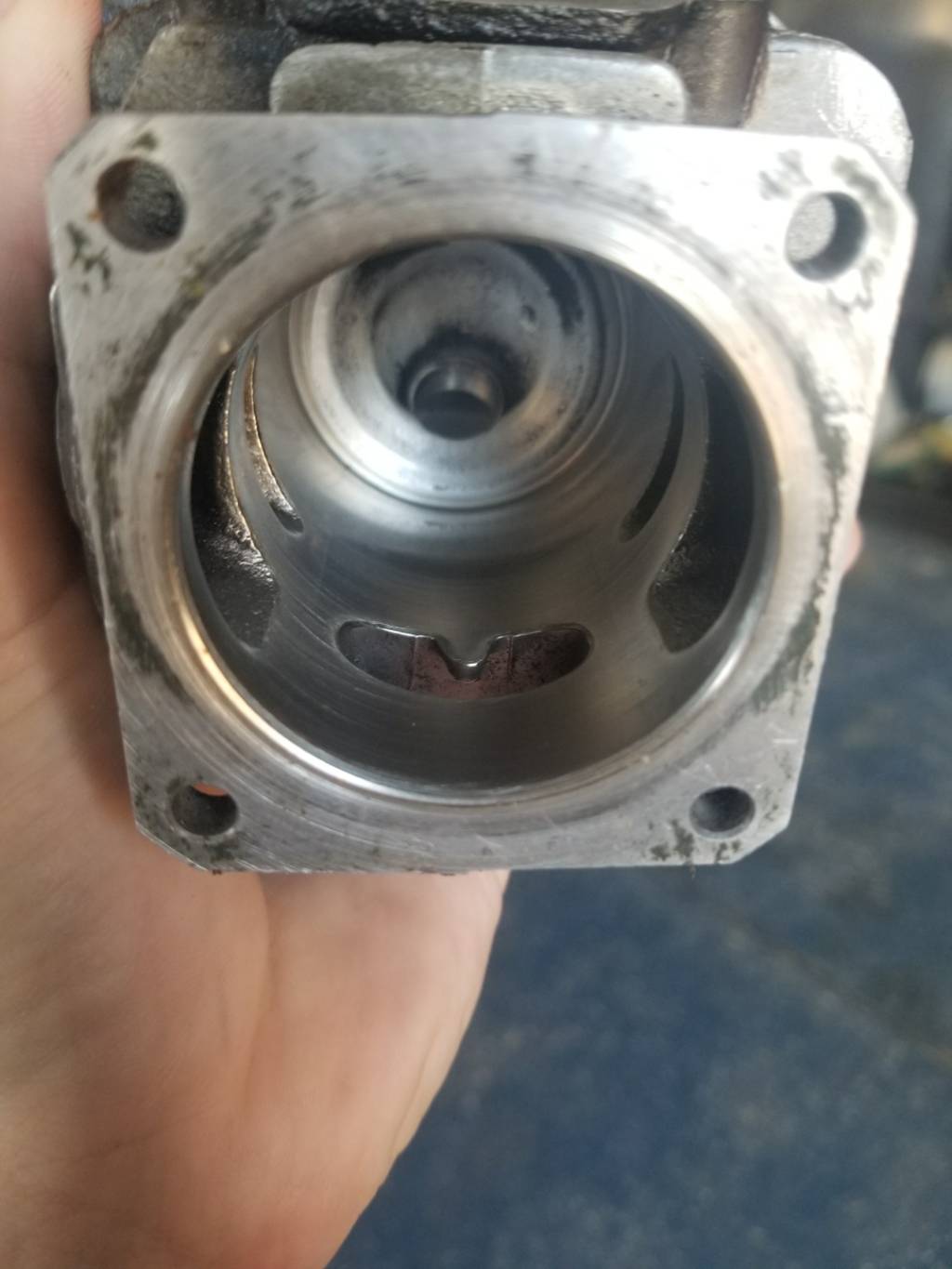

Update on the jug. I started to do a little sanding on the transfer and so far after a couple hours it looks like it will clean up. I haven't even treated it will the acid yet so I hope that'll get the rest.
I'm wondering if I can't get all the transfer off, if it is still usable. I guess I'm asking what the exceptions are or how much is allowed to still be present. Majority of the transfer has came off under the exhaust port but above the port has some left. I thought that the compression part of the cylinder is the most important and that the combustion chamber is not as important. I still would like to get all of it off but I'm looking for worst case scenario.

Pictures aren't the greatest quality hope you guys are able to see what's going on.

Another tip for what it's worth .In addition to light abrasives "Easy off" oven cleaner works to a degree .Smells like a bucket of fermented skunk rectums but gets the job done .
Thanks I'll check that out and possibly might even have some already.
All transfer should be removed.
Any “scoring” through the plating isn’t the end of the world depending on location, depth, amount, etc.
Okay so it appears to be just discoloration but I'm sure it's microscopic aluminum transfer. Feels smooth to the touch but I don't think that means anything. I'll try to get the rest of the markings off. There are nothing that I can catch my nail on but I can see it. Also when you talk about location was I correct to assume that the compression part of the stroke is the most important part? And that the combustion chamber part is not as important or is that false? I understand you still want the rings to seal and seat properly I'm just wondering if where the rings never contact is such a big deal?

You can remove all of the transfer w/o acid, just keep sanding. The plating on the cylinder is many times harder than the alum transfer.
Just be careful not to ruin any ports. About the only time you loose a cylinder is when it is gouged (ingested metal).
I'm referring to Stihl OEM cylinders, others may be less worthy. It can happen, but it is rare for a cylinder to wear through the plating.

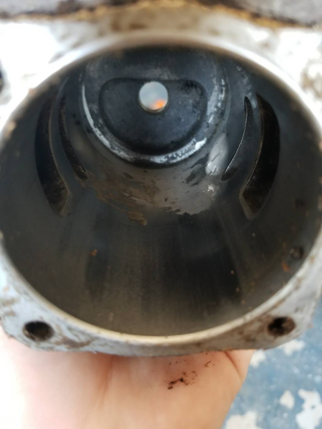

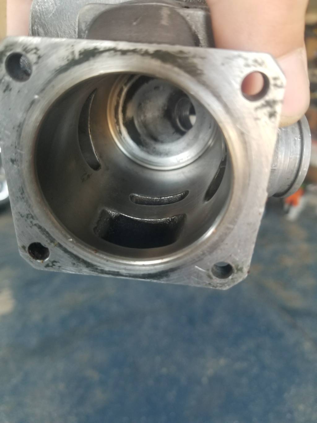

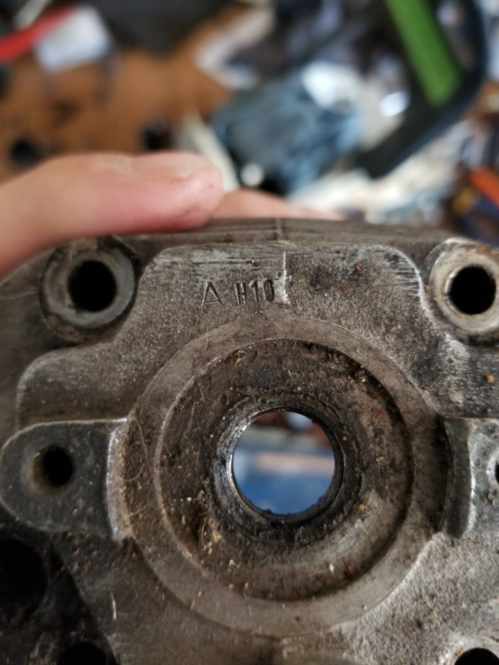

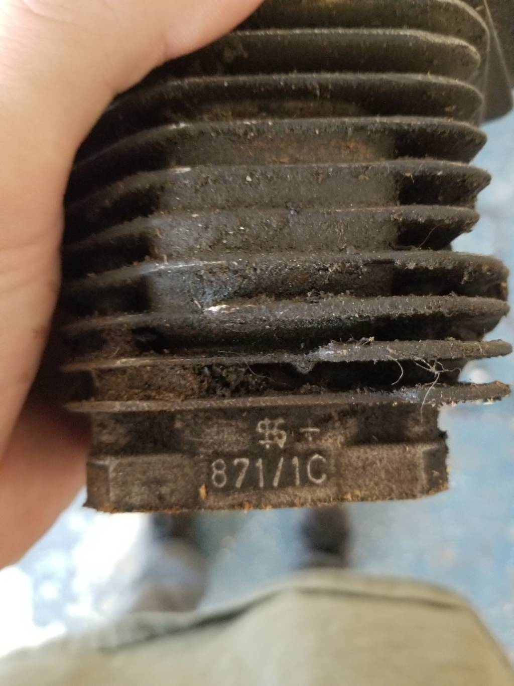

On another note, I picked up a junk yard stihl something haven't yet identified it, I assume it's 051 or the same chassis, but that cylinders plating was just flaking off, it didn't make sense to me. It was lean seized or straight gassed but it was coming off like paint not scratched off and I didn't even touch it. I'll post a pic here if anyone can help identify the model and even identify the reason that caused this.

That looks a lot like an o75/76 had the same numbers on the cylinder as my o76 jug, did the case have studs all the way through the cylinder? 58 mm bore?
Yes, it has the studs all the way through and a nut on top of the cylinder. All the covers are missing besides the starter cover.
Should be an 075/76 then, Your looking for 58mm bore, should also have a manual Oiler too, but I am no expert!! I have an o76 thou
