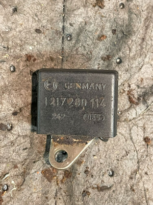

Are there any solutions out there for replacing this faulty trigger unit

There suggesting using the 031av module in that post but I'm hesitant in buying one just in case it doesn't work with my setup. The 032 IPL only shows 2 setups but the post mentions 4 different versions on the 032. One being points, the donut under flywheel, trigger unit and then the later electronic coil. Without seeing bulletins for the 032 changes
I was thinking of pulling the guts out of mine and having a go at repairing it. My coil tests good with resistances in spec and tested on a coil tester but get no spark when in the saw. What's the best way to remove the epoxy from the chip without mangling the casing?

The epoxy is a real headache. I use tiny screw drivers and pics. Time consuming, much easier and faster to replace. That is a side project just for enjoyment, not if ya want to get her repaired.

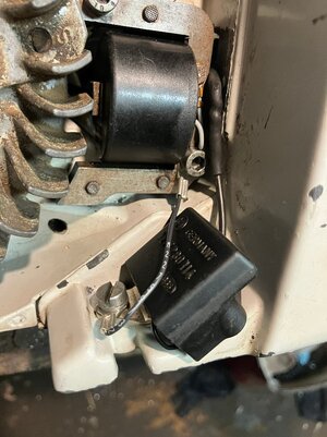

Bit of an update after some more troubleshooting with another working saw I figured out my trigger unit and coil is fine. The issue was grounding related, my saw has helicoils installed that secure the coil to the chassis so it wasn't grounding. I installed a ground pigtail from the coil to the trigger unit and now I have strong spark.
