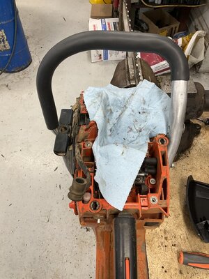

Has anyone ever tried using heat shrink on handlebars? It seems like the stuff with glue should work but I’m not sure how durable it would be. IMG_1038.jpeg

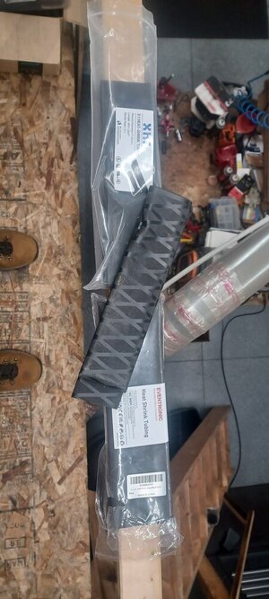

Has anyone ever tried using heat shrink on handlebars? It seems like the stuff with glue should work but I’m not sure how durable it would be. View attachment 484893
I tried 3 different brands of shrink off ebay. cut them all off after they failed to actually shrink around the curves of the handles. And, when done, the material is a lot harder than stock rubber so the anti-vibe factor is actually worse.
I have leftovers if anyone wants it, lol
Could you post a picture/ad of which style you used? This 3:1 or 4:1 stuff is significantly thicker/more flexible than older 2:1 stuff.

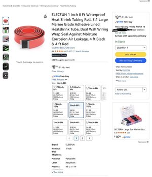

Find a length of 1-1/4" underground heat shrink tube. Underground is thicker and hot glue on the inside. If you want a lil "cush" first wrap the handle with some 1/16" thick single sided adhesive foam tape. Any good electrical supply place will have the tube, usually its only in 12" lengths, but Ive found it onlie in 24-36"
Done & Done
If you wan tot go fancy and have the time get a real thick leather steering wheel cover that is stitch on and shrink tube the ends after stitching.
3 and 4:1, 1.5”, 2” glue lined…
The cross hatch was the worst...absolutely junk.

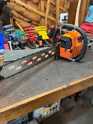

If you want damping and cushioning as mentioned, a cork lined bike tape works well and fairly durable, View attachment 486713
Looks nice. However, I was after max durability and something that for sure wouldn’t turn on the handle. The giants that run this saw tend to twist the rubber on handles.
