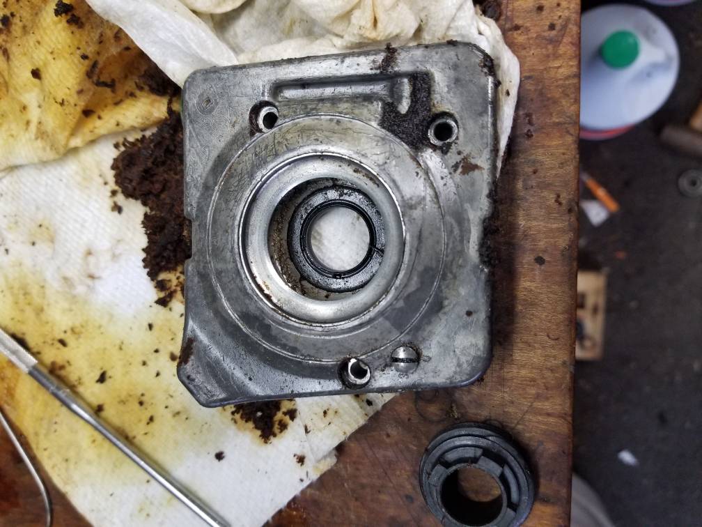

100% right steve, there was an earlier oil pump fust shield thingy, later ones just had a bigger worm gear i think
The holes for said worm gear are different as well. All I know is that you need to stick with the same stuff, no mixing and matching going on.

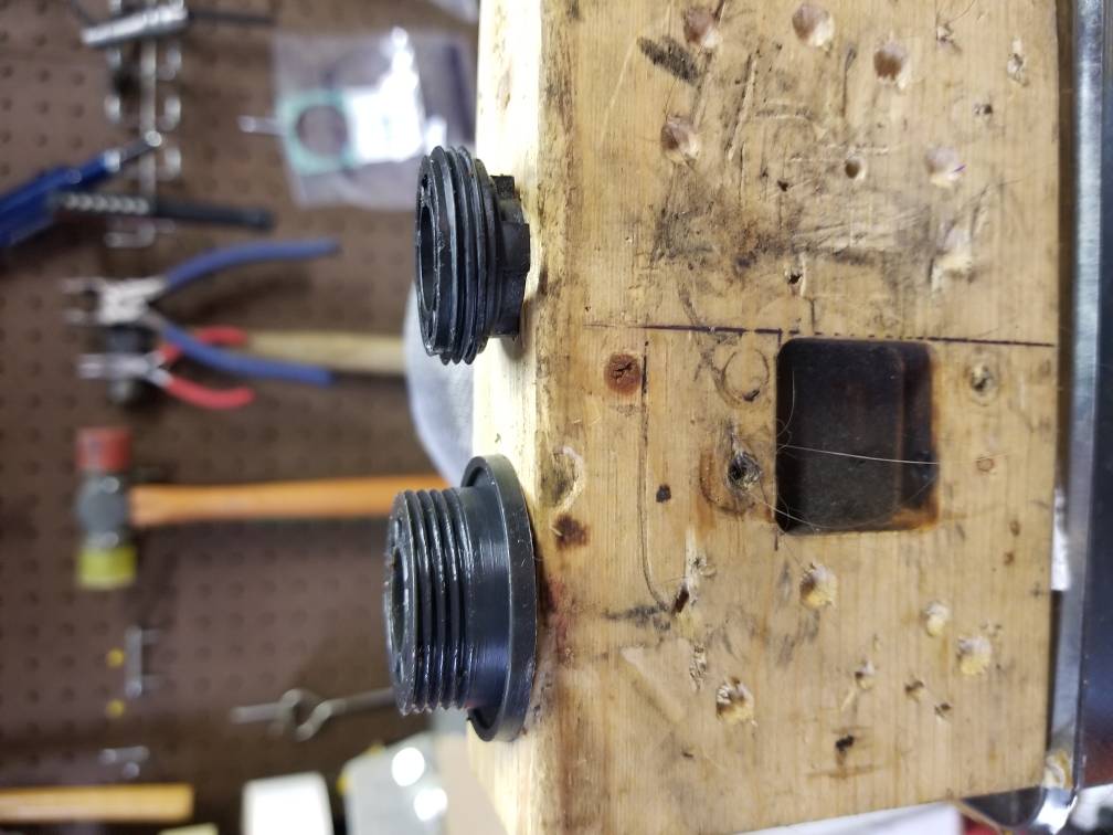

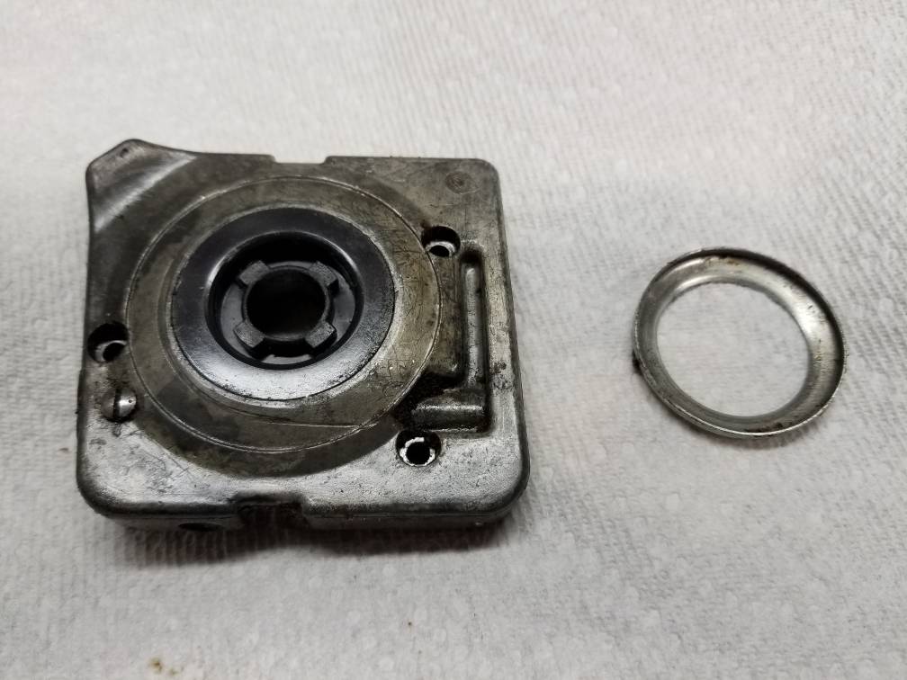

My 281 project is also a very slow mover... here are the pics.
1. My 281 oil pump
2. Both 281/88 worm gears
3. Ring out and 288 gear in

Unless I’m mistaken, Yer missing the dust ring on the smaller worm gear assembly Dan.
