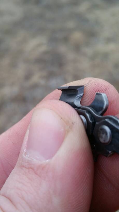

One thing that I noticed is the pictures of the links do not have marks above the rivets from the grinding wheel. They said at least number 3 was from a swing arm machine. I wonder if they are thinning the underside of the wheel to clear ?
Their side angle on the wheel is probably real thin by the looks of the chain

5,613
Nottingham,pa
Another item that struck me as odd was the comments about the gullets. If they all picked up speed when they were cleared, why wouldn't the people sending them in do it. The multi stepped angles in the pictures were serrated looking.
Laziness is my guess. When I ground I wouldnlet them go. Filing it's harder to do with a gullet in the way
If they did hit the strap, looks like it has been cropped out of the picture.

I suppose they would be DQ'd for weakening the tie strap.
I find it interesting that the #1 chain in the bucking cut didn't make an appearance in top six chains.
I'd love to see it...
