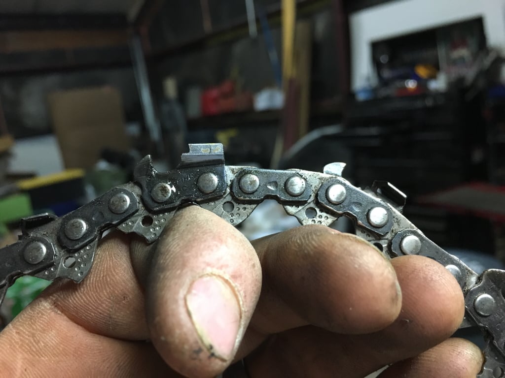

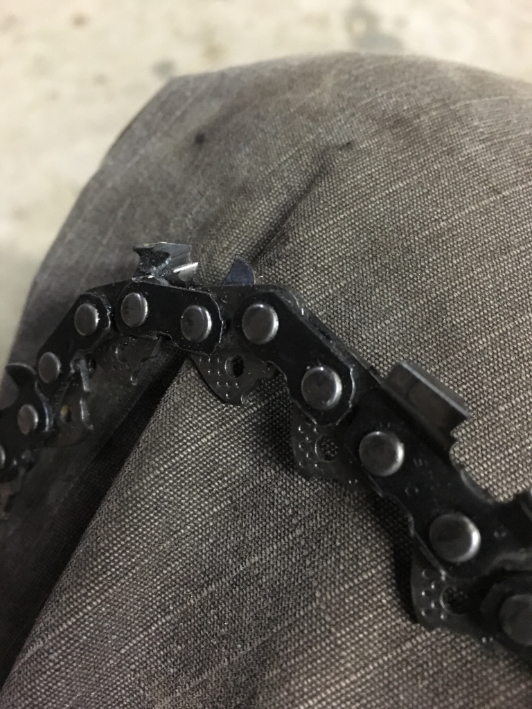

I've been grinding at 26 degrees on the top plate and just a slight forward lean. It cuts well and has been durable, but I need to drop rakers to .030-.035.
I just got an all but new rs2 that has the original wheel and it's at 20 degree top plate. I'll try it and see how it holds up.

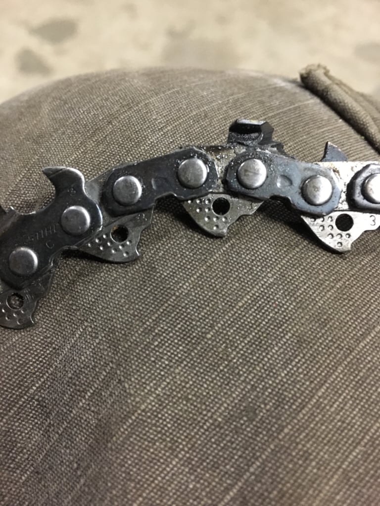

At 20 degrees
