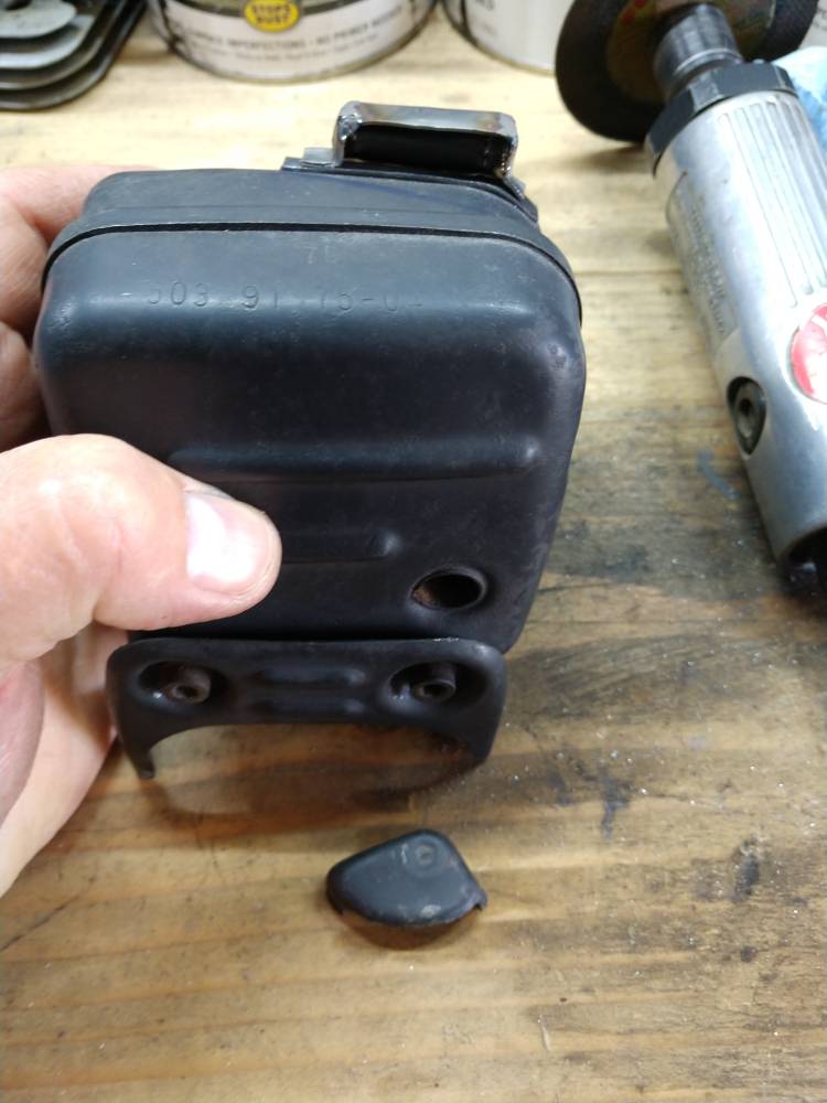

Got a little carried away with the foredom on this one. Just opened up under the deflector after removing the cat tube but it was too much.

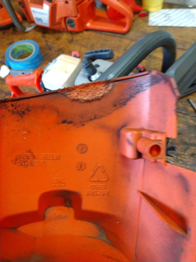

Started melting the top cover and I can't have that, this saw is too nice.

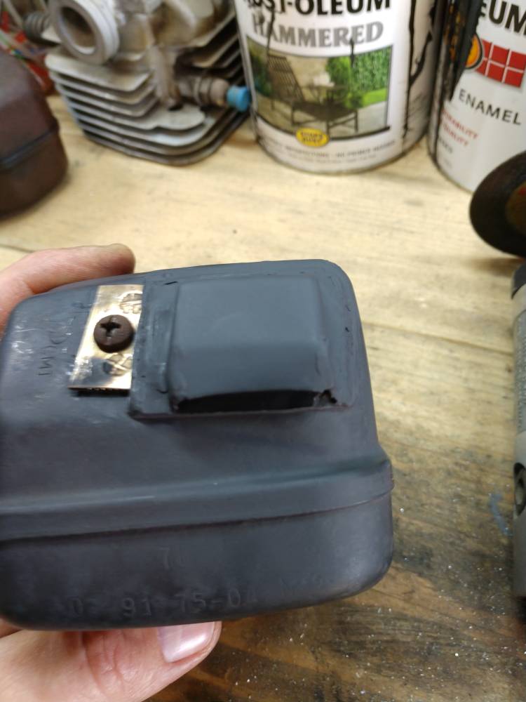

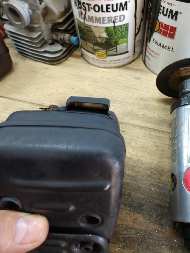

After a bunch of cutting and tweaking it's starting to look like something I can live with. This is the second go round, I scrapped the first idea. This pic shows the original deflector as well.

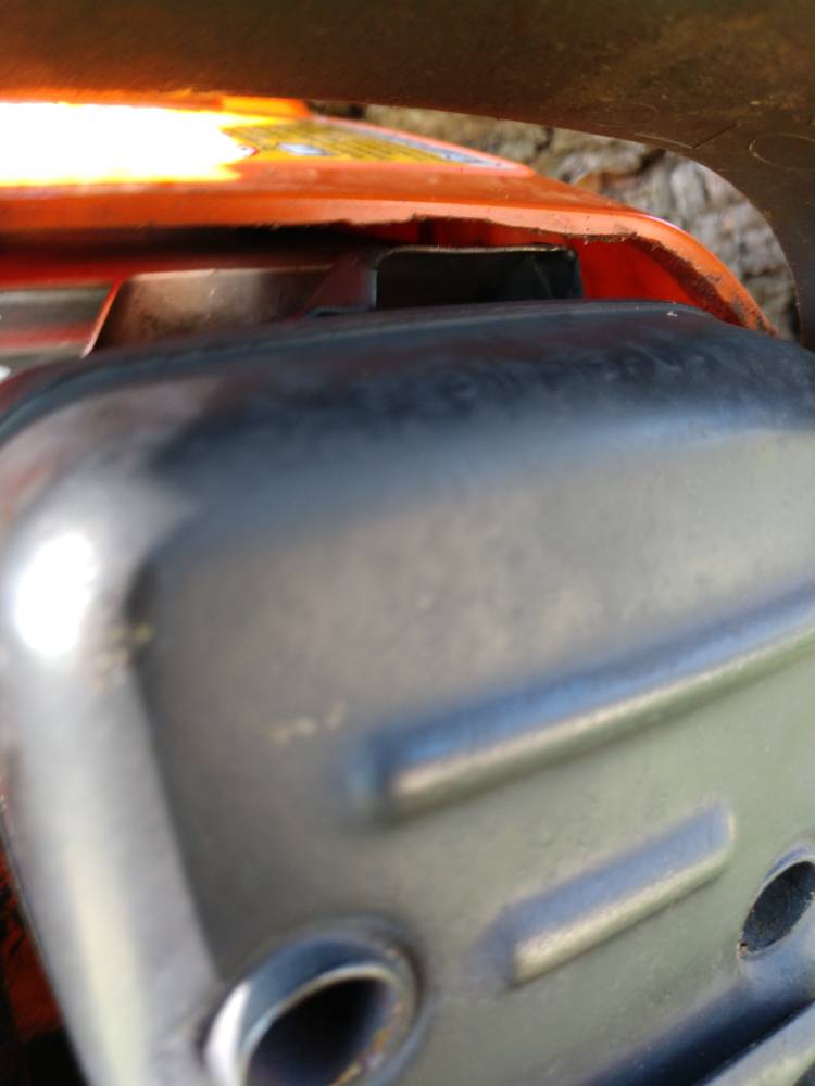

After some welding, grinding and paint I think it turned out pretty good. Still need some heat shield tape for the cover but it's at least directed away from it now.

Time will tell how effective it is. If it still melts the top cover I'll weld it shut and go out the side. Next time I'll leave it alone and do just that.
