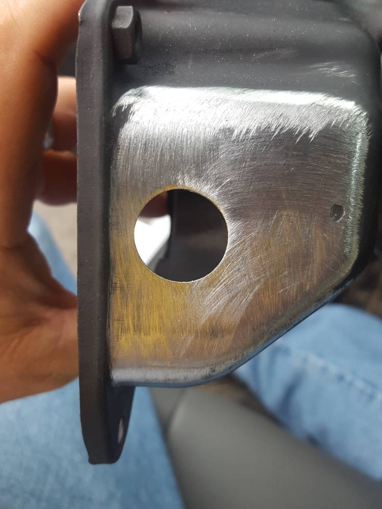

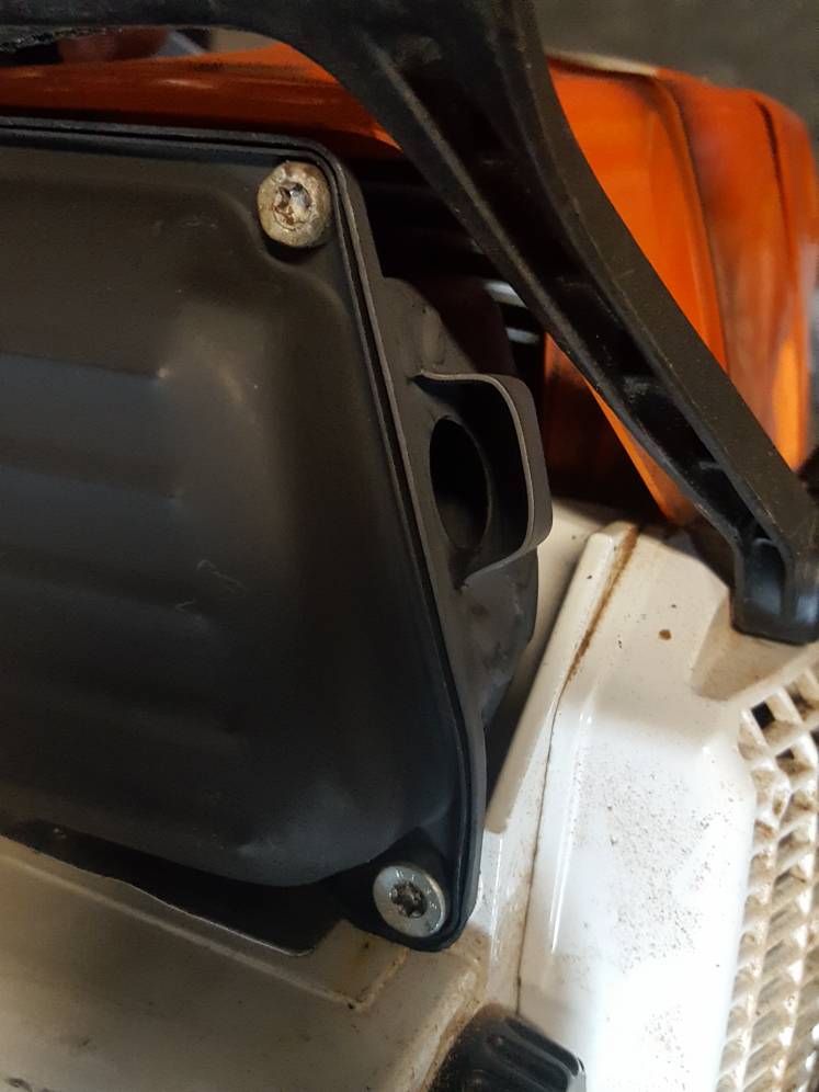

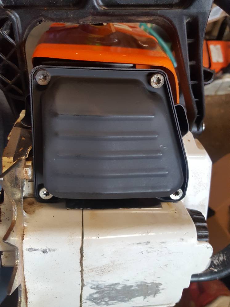

Whew!!! Big Kevin...[emoji16]
I think one outlet would be enough
The ported 90cc saws I do usually have 2 of these 1.5”openings and run extremely well, this ported 120cc saw has one, plus the factory opening is as big as its deflector will allow. I’m considering adding another opening ............
47E8DB49-67DA-45B0-B4C3-9775AA36E98F.jpeg 6B5A1D07-891A-42EA-A801-06BA8F092408.jpeg 1ED693D6-CBC8-4309-9633-493E6654B992.jpeg 3E18DE5D-5E6C-48D3-90B4-AE9A6A7BB485.jpeg
*Edited to add pictures of it painted & on the saw
