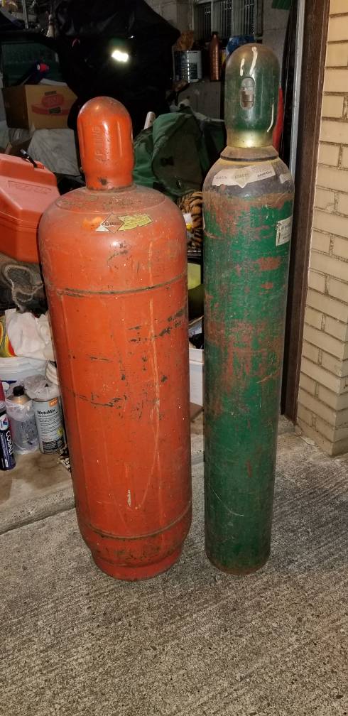

Nice setup! I finally picked up my tanks today! Where did you get the flashback arrestors at?

Ok my setup is older than dirt. Just wondering what I need to buy?
