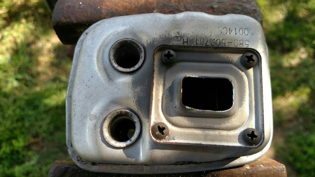

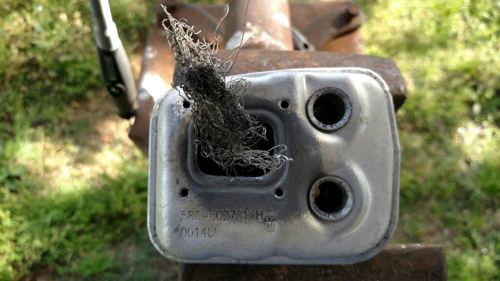

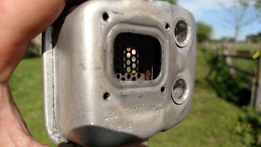

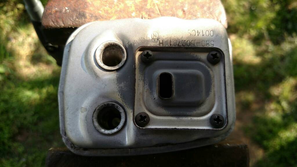

Husqvarna 125 blower cat muffler

I hate specialty tools. Dremel cut off wheel works great to make slots

That sounds good in theory but in practice its not going ot be a fun job with 1000 spot welds to find
Anything that is attached to the can near the ex port leave in place for extra support and prevent cracks. Cut off wheels, burrs, and tin snips and you can have the main part of the exhaust tube gone.

You guy's probably do this but I've been taking an egg shaped carbide burr and cutting through the tube walls of the cheap 372 mufflers i clock the cuts away from the top tubes towards the center.
Terry syd gave me the idea works great doesn't make it much louder.1492353994726-1393985632.jpg 1492354033693-1495355552.jpg 20170416_095738.jpg 20170416_095229.jpg
