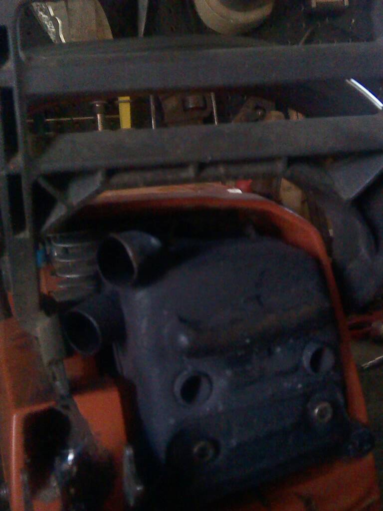

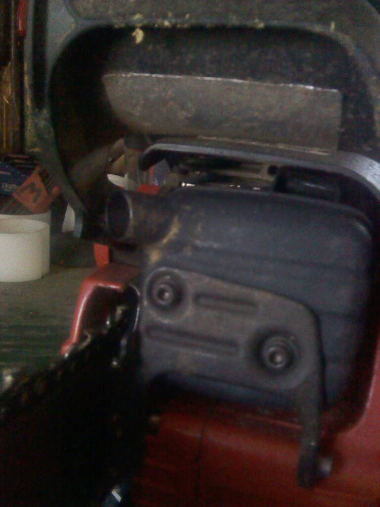

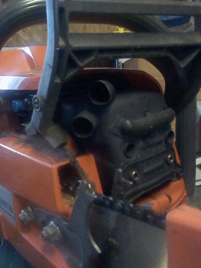

Doubles on a 371XP. Used two 3/4 inch 90 degree copper elbows and brazed them in. It sounds real nice.
Single copper elbow on a Jonsered 2152.
