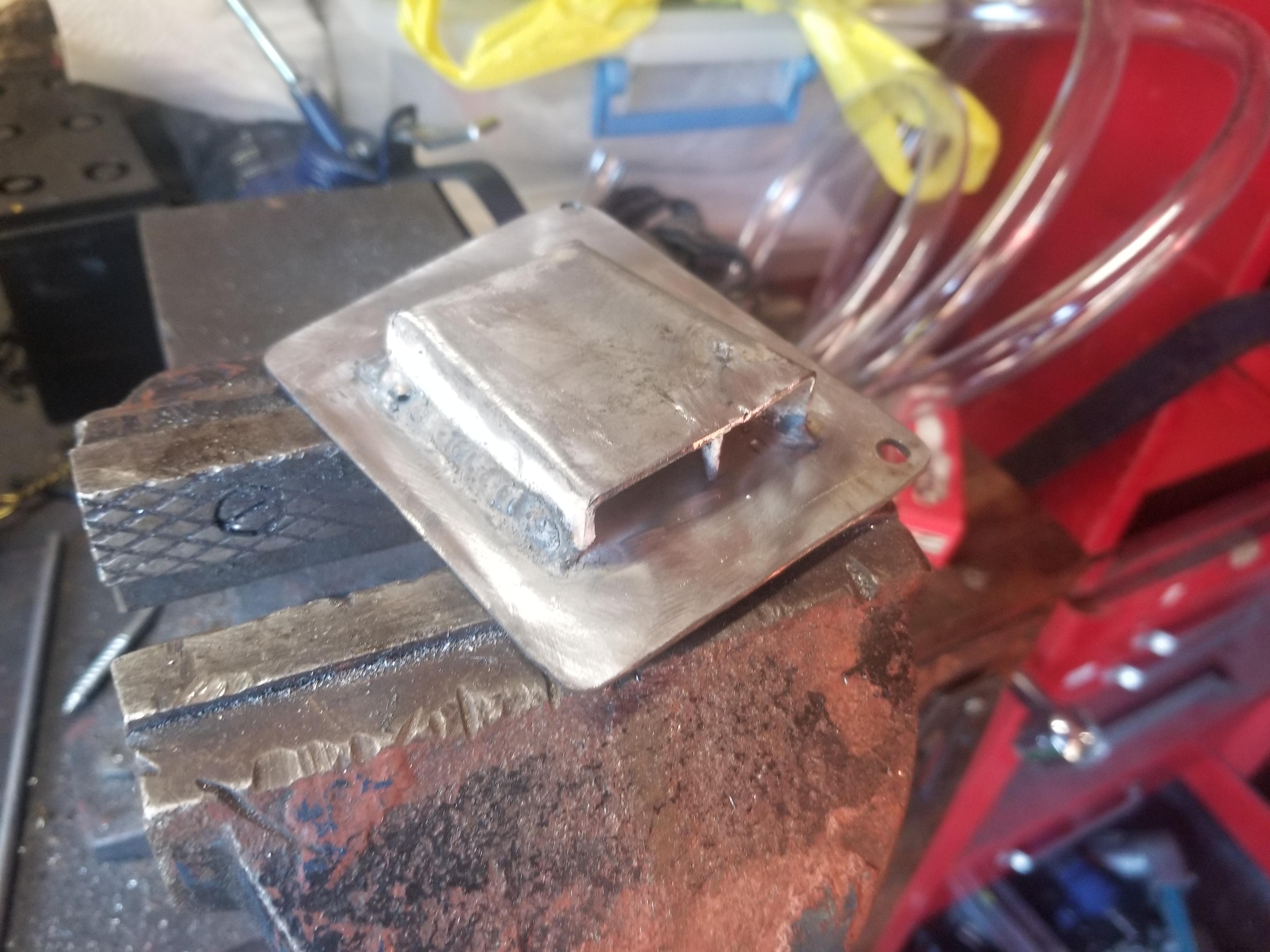

Front cover mount holes broke on my 038 so i made a new cover

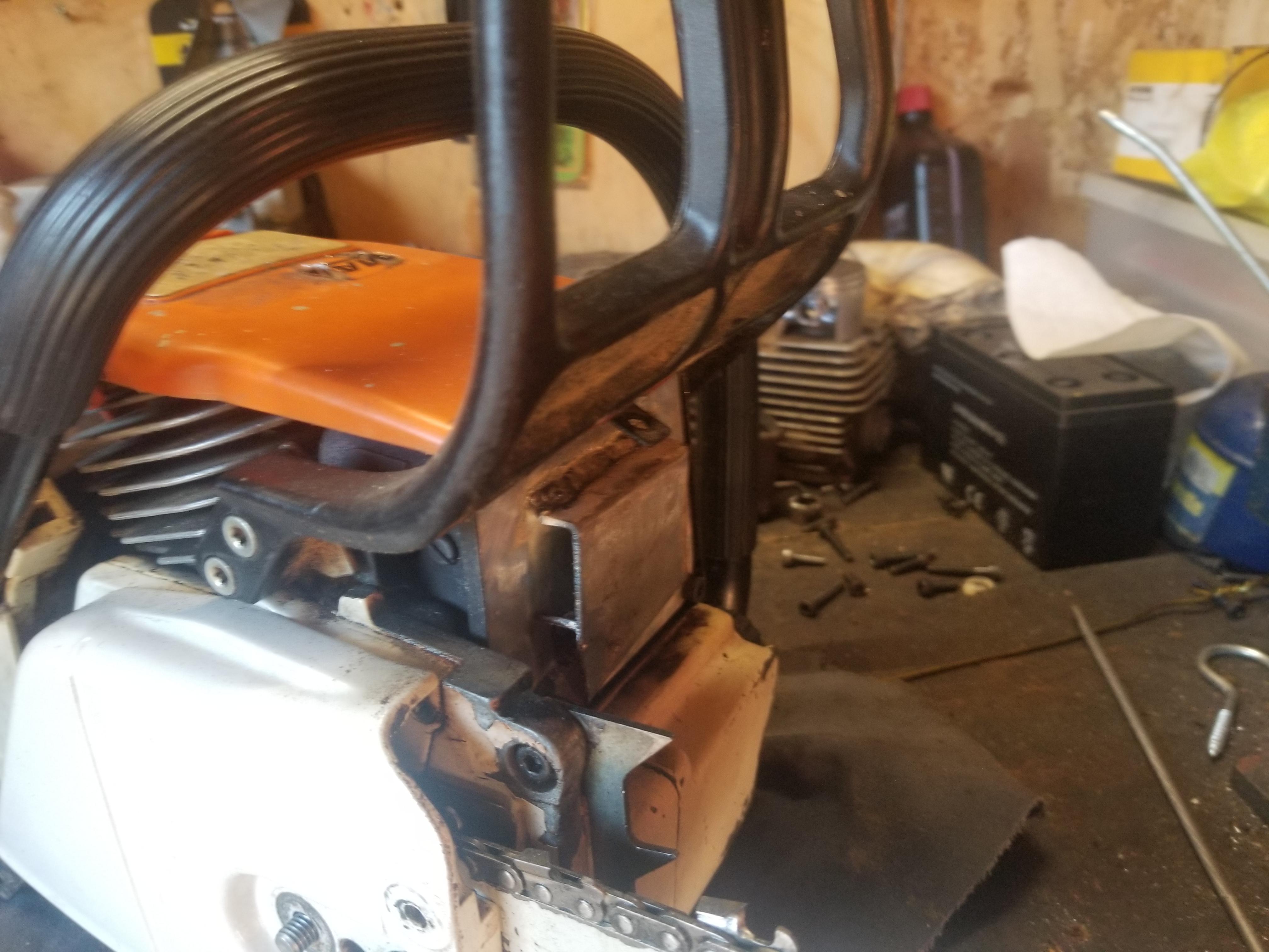

Upper is factory muffler for some reason finished pic wont load.
I run 1" ports. Single port, I stopped doing dual ports.
I close off factory ports or in the 084 case run a 1" oval port to clear in factory location
