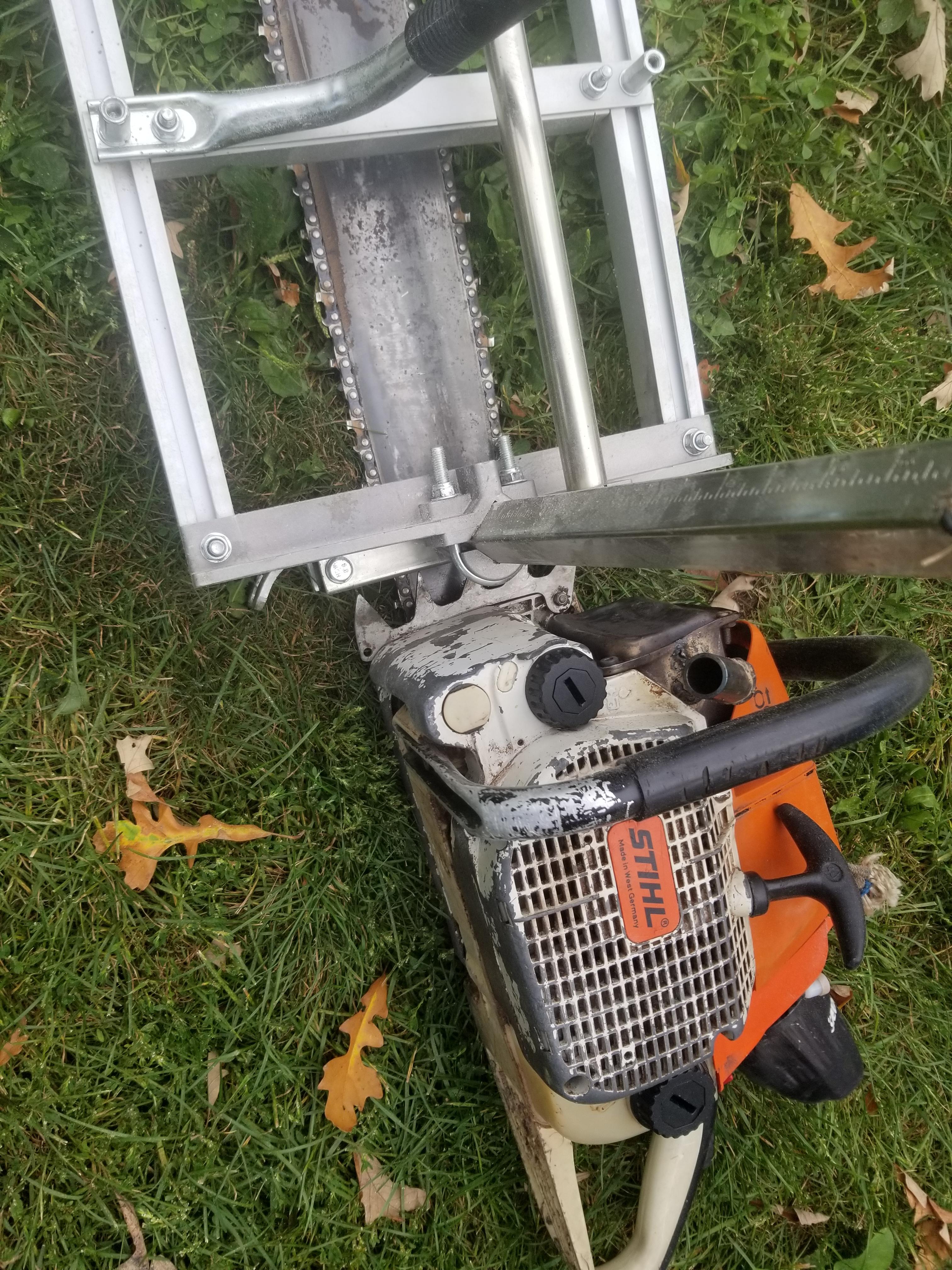

Milling muffler mod. Im sure my neighbour behind me loves it. It points at ther house when milling.
What are you using for an air filter?

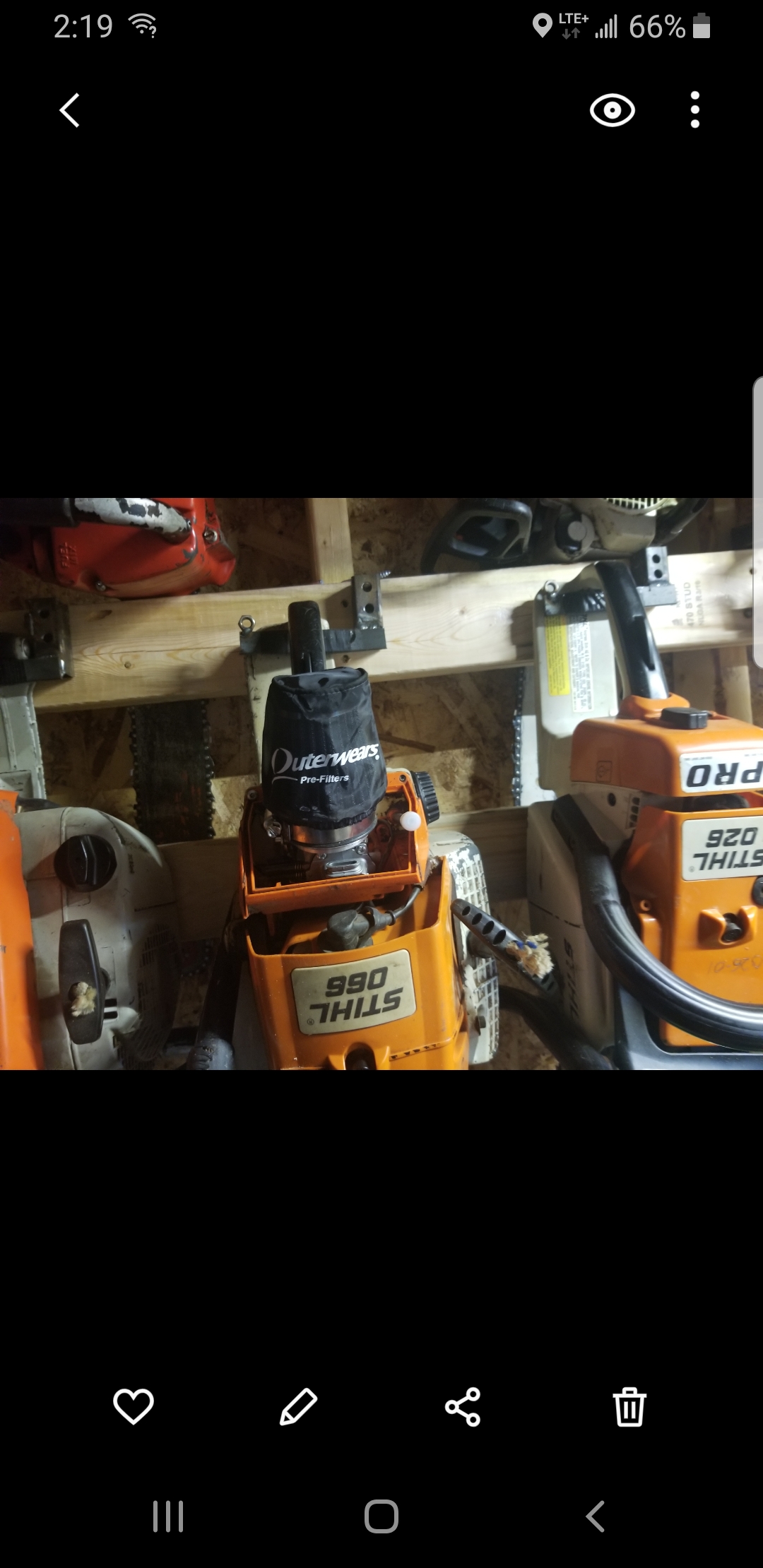

Its a k&n style filter with a outerwear pre filter. The pre filter works ausome. I do my milling at home so i blow saw out after every cut. For the air filter i just blow the outerwear bag off quick and about every 5 or 6 cuts i pull prefulter off and blow out the main filter which really isnt too dirty after all that milling.
Highly recomend them. I am gonna be ordering Some for my other saws
