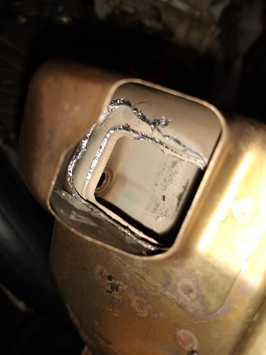

I modded this one because the original deflector was gone and so were the holes and most of the area where it attached. Small piece of rectangular tubing. It's on a McCulloch Super 10-10 I'm restoring 20201028_141111.jpg
