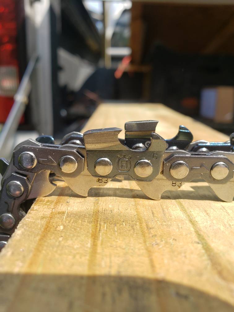

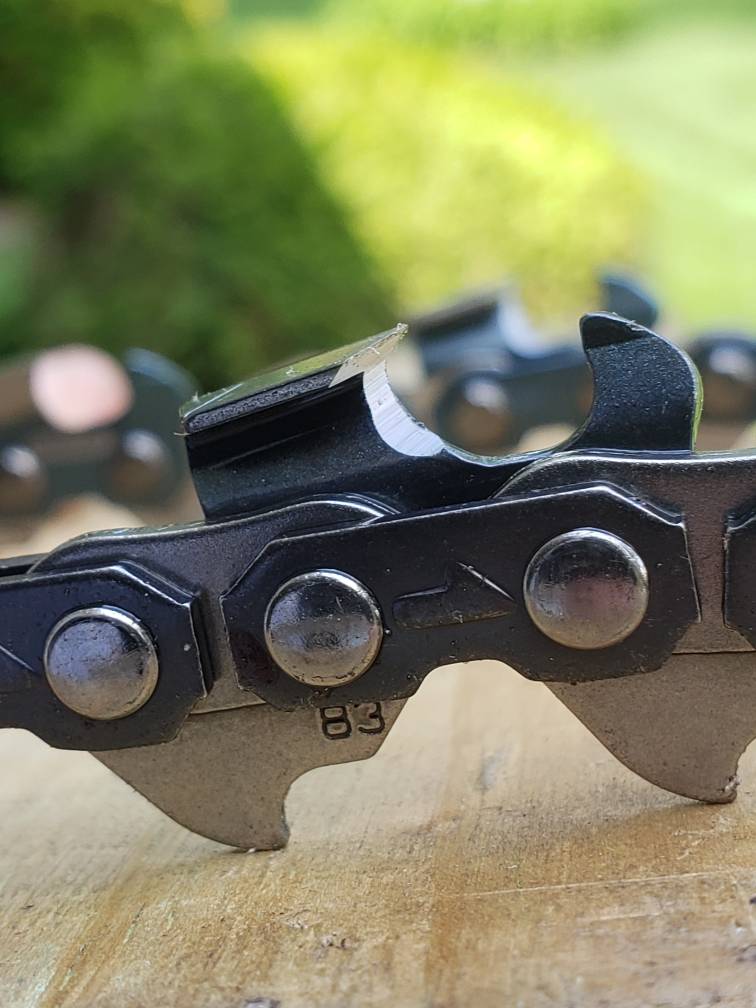

Carlton I have never cuts as good as stihl or oregon exl. Too rounded on the top plate corner I think. Really a semi chisel almost.
I use Carlton most of the time. Factory grind isn't great but it holds up well in dirty wood and I like it after a once around with a file.
I am a fan of Stihl chain though...but don't tell anyone.
huskyboy
Sorta a husqvarna guy...
1:02 PM
1352
May 30, 2016
10,026
43,492
Ct
Holds up great like you said because of that more rounded corner though.

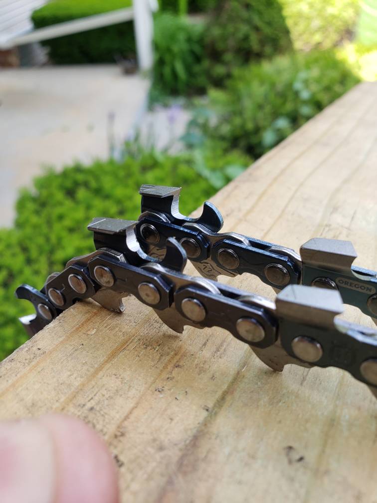

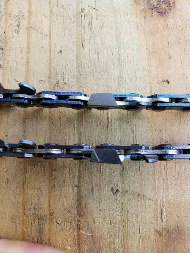

Carlton chain is difficult to sharpen. Cutter looks like its all chrome. Kills files. Doesn't cut as well as other chains.

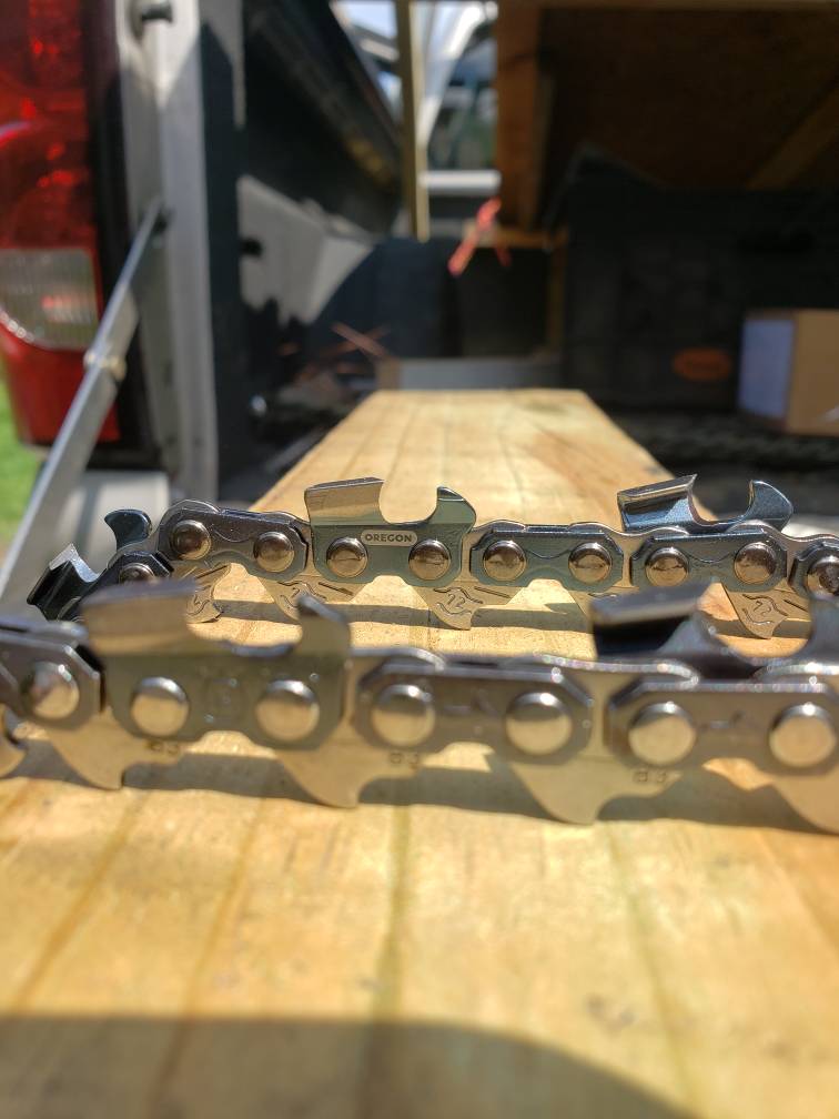

Exl and c83/c85 are my favorites. Cut nice out of box, hold up decent, file decent and are affordable. Stihl chain is great too but more expensive... usually.

Husqvarna C83 chain and Oregon EXL
I'll have to disagree. It's not as hard as Stihl chain, I've never noticed it killing files prematurely either. And I use a lot of save edge files.
