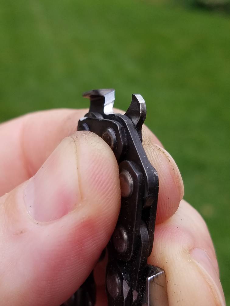

Jeff, looks nice, but when converting to square, you don't have to do the whole tooth all at once. I know you have run my saws when I have just hit the corner, and your (and others) were impressed by how it cut. I keep doing it and it eventually converts.
Also, you sure choose a tough piece of wood, but the saw looks good!
Thanks Mike. This was a chain that I got with my 036 when I bought it. It was rocked so I had to take quite a bit off to try and get the peak corner angle point back.
But I know what you mean.
Still learning every time I square file.
