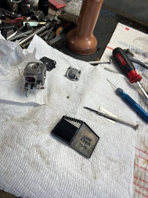

However, one word of caution (and I almost never question one of Randy's recommendations), but when I did timed cuts with my 044 and took off the Zama (non-snorkel) carb and replaced it with a Walbro .070 jet, it was slower, so the Zama is still on my 044!
