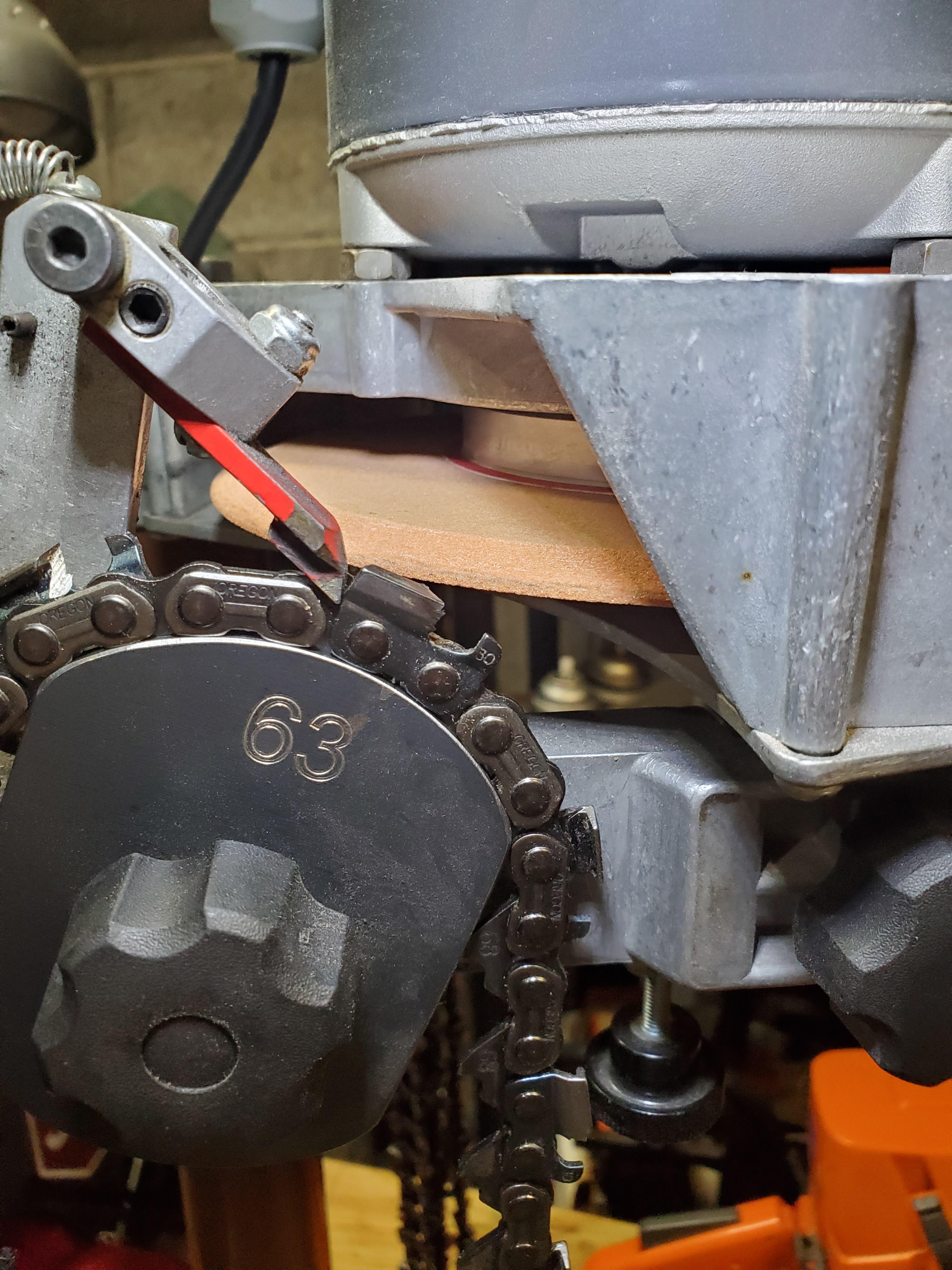

.404 getting a makover...

Tried the WCS depth plate. Think I’ll try the next higher setting.
Higher…..as in more swipes or less swipes? Can’t really tell if you’re pushing it or holding up on it.
What did you end up doing for a carburetor? Did that one I sent you work?
