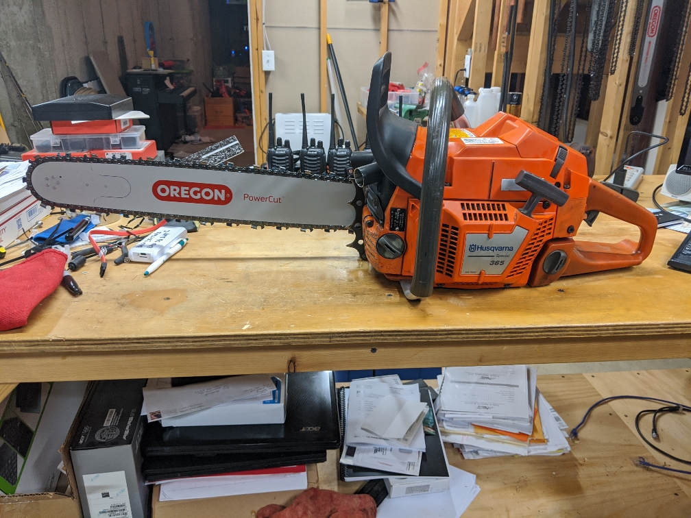

The new bull horn muffler and bar/chain for the 365. Hopefully good weather this weekend so I can make some test cuts.

Any of you guys recommend a replacement dog that with a little bigger teeth to help protect the exhaust on this mfer? Hoping to avoid crazy big west coast dogs... Something between stock and obnoxious.

The inner 562 west coast spike and slot the bolt holes to fit.

Thanks Mason I'll check that out. Did a piss rev tonight and man does it have pressure coming out when at idle ... Nice "Pop Pop Pop" sound at idle like most 372s sound. Can't wait to see what she does in wood.

Maybe u should cut the pipes in the middle, then you don’t have this problem

Buy the whole full wrap kit and get the spikes with them. They’re the size they should put on them to begin with. The 5 point pro safety are too big for a 372. Ive tried them and you have to have a real light hand to use the bottom point.
