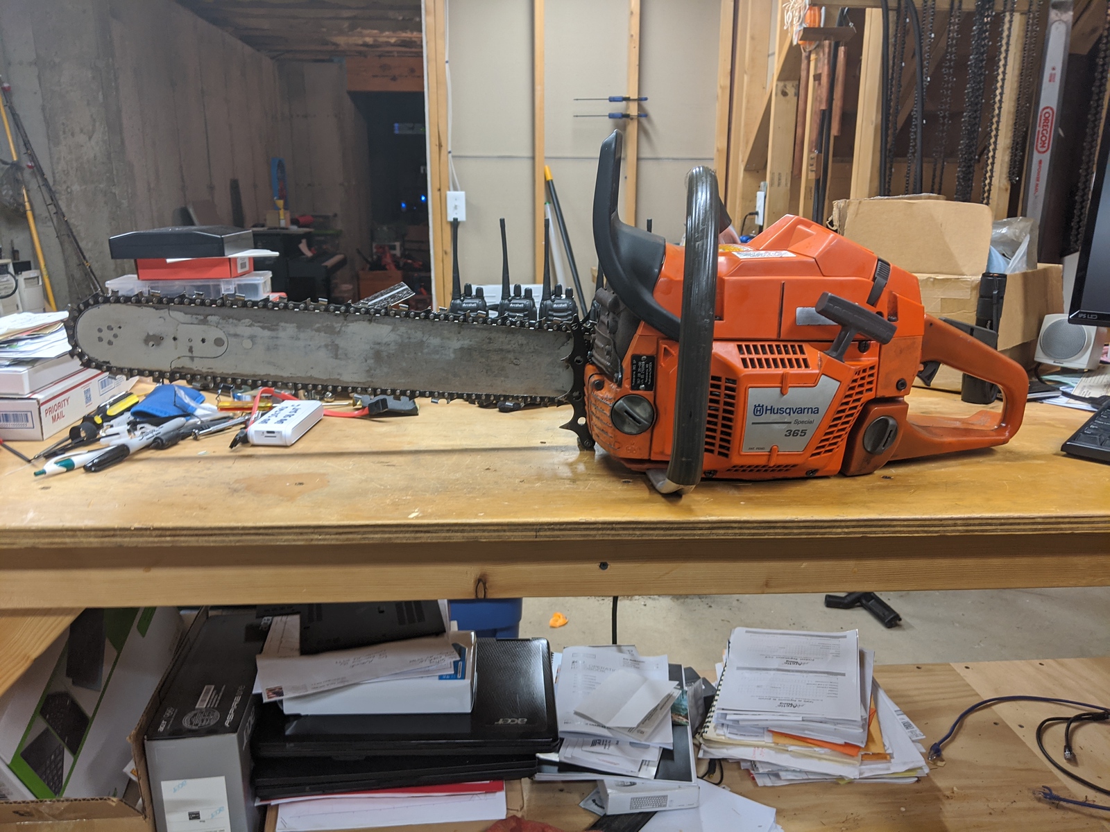

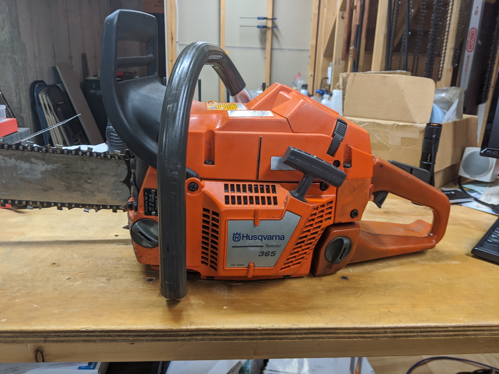

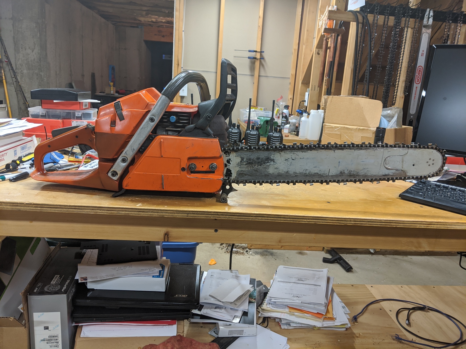

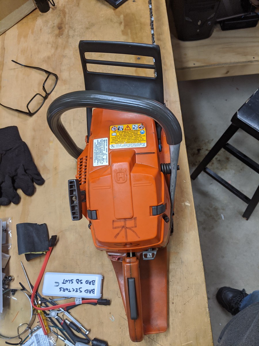

Here's what I was doing when @huskyboy @RIChevy and @WillG and @SOS Ridgerider were making the videos posted above and cutting / stacking some firewood for our host @paragonbuilder
365 Special w/ blown needle bearings where connecting rod meets crank.
When disassembled and case split, the low end and cylinder made it through unscathed. Needed a new piston.
Completely tore saw down, cleaned, and got a used 371 crank to save money there.
New OEM bearings, seals, gaskets, lines, tank vent, piston (I believe 48mm).
Carb in great shape -- Walbro 12B ? Can't remember number -- Mason would remember.
Gasket delete and squish ended up about 0.018".
Got a bull horn style muffler coming from a guy in Canada who makes some really nice ones welded and painted up nice.
New bar and chain coming as the one on it was abused quite well.
Clutch in great shape (no blueing from abuse) and tonight finally tested it completely assembled, but not in wood -- oiler working as it should and holds tune at 13,600 WOT will probably back it off a bit for break in. Idles and transitions perfectly. Excited to test in wood once new bar and chain and muffler arrive!
And since this is the "saw video thread" when she hits the wood I'll try and get some footage. Definitely excited to see this thing run even though it has only had gasket delete and bull horn muffler.
It's older w/ unlimited coil which is nice. Also obviously not a strato (xtorq) either.
