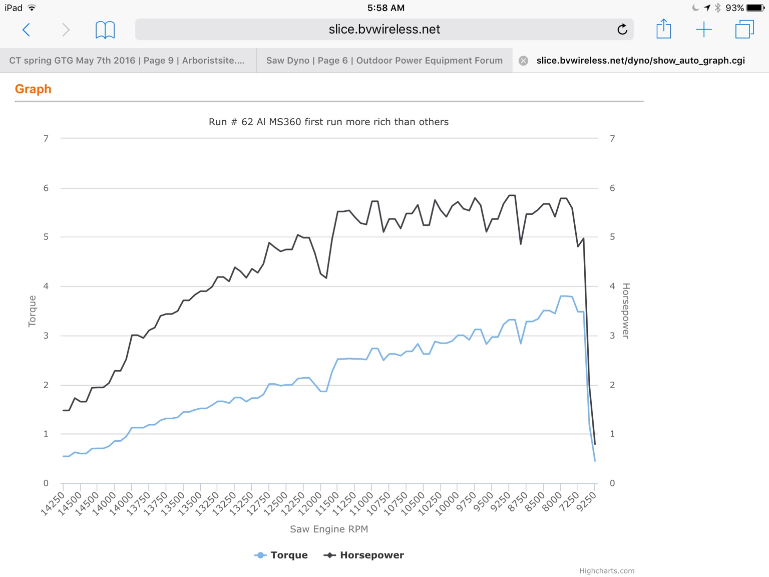

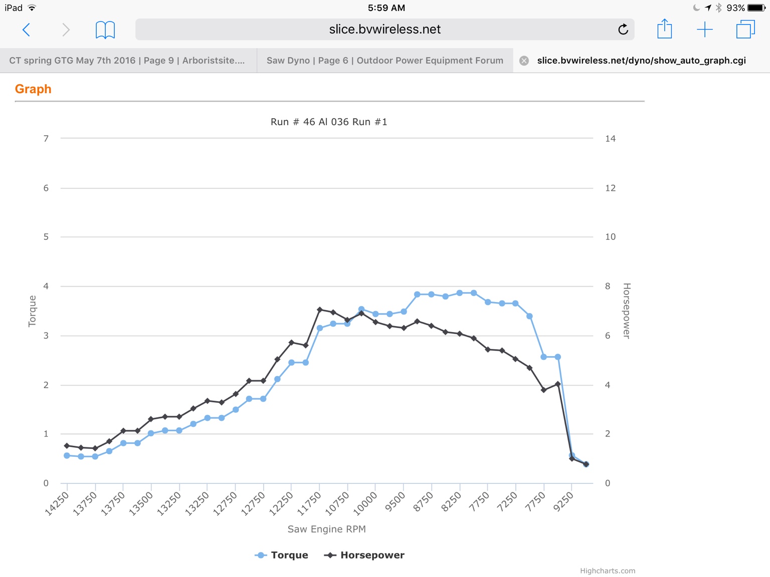

These were the most important Dyno runs for me.
My 036 has an OEM metal aitfilter on it.
My MS360 had a super restrictive flocked OEM filter on it. The type that's tough to breathe air through. I swapped to nylon at one point, which was less restictive. I even leaned her to 15k with the nylon and made between 6-6.5 hp. Then we ran her with no filter at all and she hit 16k. The results were very suprising.
I'm sure the air filter gains are like all else in a saw. It's gotta work together. On a stock saw, this wouldn't have had the same effect. I wish I had @Backtroller saw with me. His is even faster.
Forgive me if the pics are out of order. Doing the best I can.
drf256
Dr. Richard Cranium
2:01 PM
319
9,666
63,782
Strong Island NY
Remember it's the difference, not the total output that matters here.
These are not necessarily true HP outputs. This is for showing the difference one factor can make. The curve of the no filter exaggerates the output, so does the rpm. Please keep that in mind.
036 metal filter
360 flocked
360 no filter
