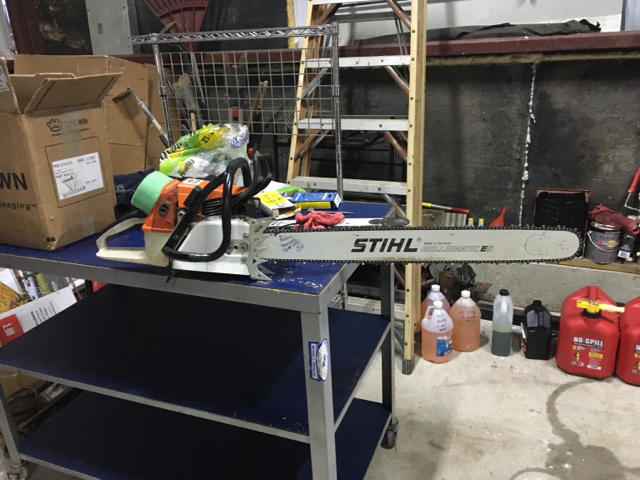

I'm anxious to see a particular saw on it.
2 saws actually.
This one?

This one -- I think from Saw Dr.'s youtube channel (which I just subscribed today).
