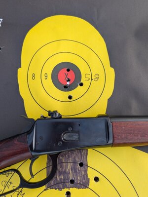

Took advantage of the day off to try some stronger loads in the Rossi with Accurate #5 and the Lee 125 at 62 yards. The loads were 7 through 8.2 grains of powder. The 7 and 7.2 grains in the upper left were fired with the sun in my eyes so I had to adjust my position. That 7.8 grains is really tight, I think I'll switch to that in both .357's as long as it shoots good in the Marlin.PXL_20251128_172919557.MP.jpg
