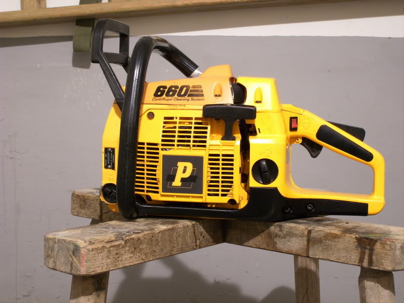

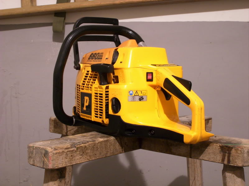

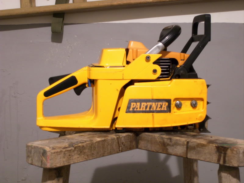

Oh how times have changed! Compared to my 394 they are quite close in physical size ,Its a large saw. They really could have expanded on this platform.
Yeah, it was the old-school faller crowd since these saws came out in the late 80's and there were still a lot of guys in the woods running 056s and 2100s. Even the "lightweight" 064, which was a revolutionary falling saw when it came out, got a chilly reception from the hardcore old-school guys.
This is a good platform - they also had the Partner 660/Poulan Pro 445 on this same chassis which had a 50mm bore and quad transfer ports like a 372.

A new outer felling spike was fitted.
Those look like they have the same tooth pattern as the HD 371 West Coast spikes @jacob j. sent me for my 372W, and the holes are also similar to the J-red 2094 dogs. Kinda funny to think of the 371, 2094, and PP475's all being produced in the same general time period. I still think of the 372 platform as being a "new" saw, and Poulan/true J-red saws are all antiques like David Bradley's. This saw made me realize/re-remember that US companies were still trying to compete with the Swedes, Germans, and Japanese up until not that long ago.
