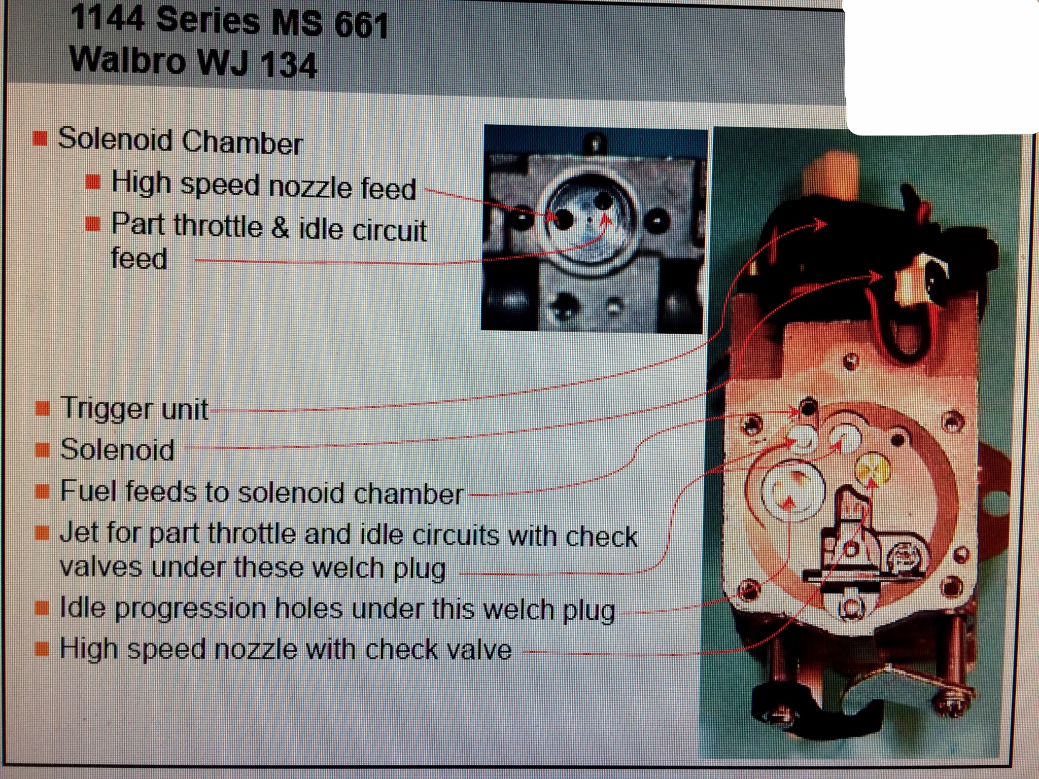

Georgia
This may help if anyone wants to mod or test the carb on it.
