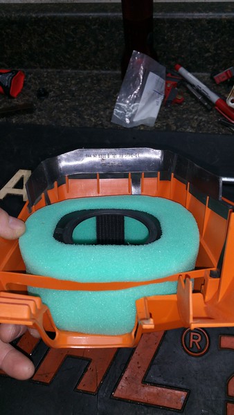

The MaxFlow for the 661 is a thing of beauty and it stops all fines from getting into the intake as well as flowing enough air to make you think that you're running without any filter IMG_3593.JPG

The MaxFlow for the 661 is a thing of beauty and it stops all fines from getting into the intake as well as flowing enough air to make you think that you're running without any filter View attachment 53346
Really is noticeable how the air flow is....some may say it is less.
I think it is noticeable in power.
Really happy I bought one, may end up getting the 064 kit even if it looks boxy
Sent from my non internal combustion device.
It don't look boxy if ya ditch the cover.

You can modify the stock filter cover to work with the MaxFlow.

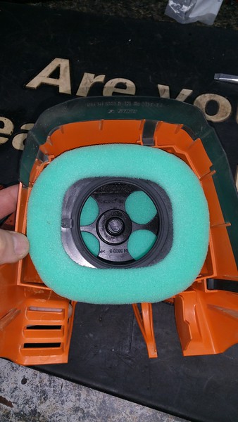

Thanks again for the testing Julian. I didn't notice, but are you still using the green foam filter?
That saw runs real good. And god bless you for cutting in what looked like darkness and snow for the good of us all.
