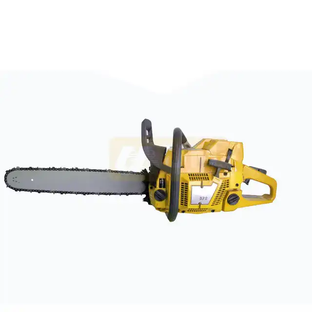

Are these all being built with aftermarket topends? Is there a option of getting a oem kit if you are building them with am p&cs? As always very nice work.
Thank you.
A few have been good used oem top ends
This last batch has been aftermarket.
Oem is an option but adds 250$+ to the price. Stihl is mighty proud of the p/c kits.
That is all discussed with the customer when they order.
Now truthfully, these am jugs weld 10x better than the used oem. Don't have years of oil baked into them
I figure if the plating will hold up to the welding/porting it should hold up in service. Throw in a meteor piston and caber rings, seems to be a very solid option.
These am castings are thicker. More room to move/shape the ports.

Thank you.
I've got over five year's on some of
Bat country's finest 372s mostly.
They still running all the shiny stuff still in place.
They have yeller saws now.
