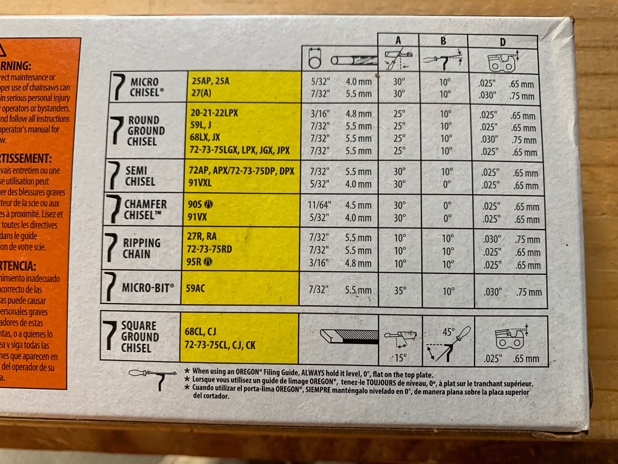

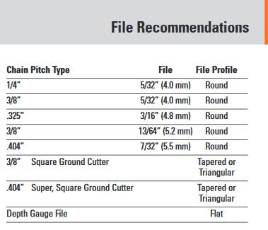

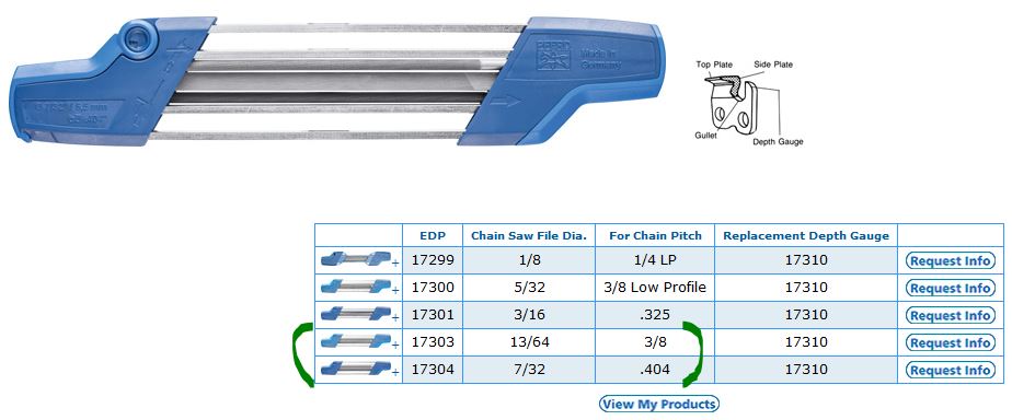

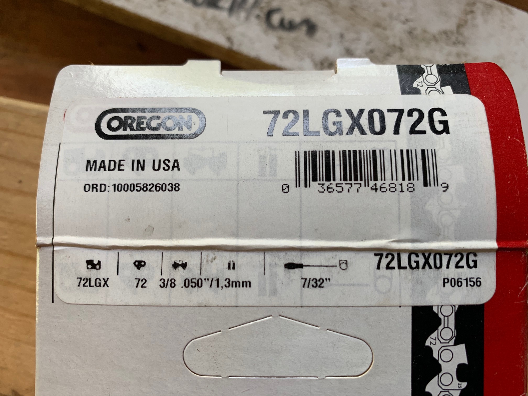

As some others this thread have discussed, I think the trouble starts with the fact that some popular Oregon 3/8" pitch chains specify a 7/32" file diameter, however if you look up which Pferd model has a 7/32" file, that model is intended to be used on 0.404" pitch chain with a 30deg cutter angle.
This is exactly the case for my favored Oregon LGX chain -- it's 3/8" pitch and requires a 7/32" file on a 25deg cutter angle with a 0.025" guide depth. Box below as an example.
Stihl, for their roughly-equivalent in-house 3/8" pitch chain such as RSC, specifies a 13/64" file with a 30deg cutter angle.
So based on this, the Pferd 13/64" model is suited for Stihl 3/8" pitch chain, and not so much for Oregon 3/8" pitch chain.
And, as was noted in this thread, using the Pferd 7/32" model on non-Stihl 3/8" pitch chain can result in anomalous depth gauge height because the "guide link" is not in the right place (due to 3/8" vs 0.404" pitch) .
