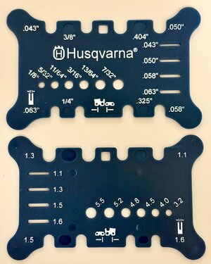

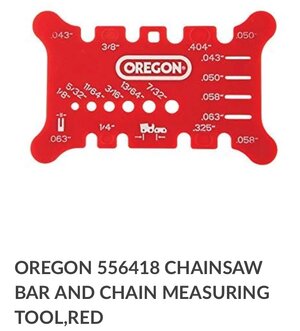

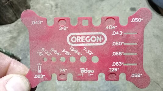

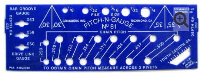

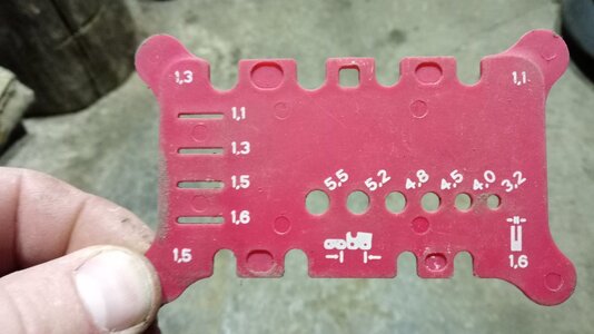

Not a problem if you run just one chain, or one brand of chain, on one or two saws.
But if you deal with different brands, with different identification codes; and different chain sizes; or work wih other people’s chains; these help to sort chains out quickly.
The Oregon and Husqvarna versions are clearly similar. The Granberg covers some ‘vintage’ pitches. The STIHL is the hardest to lose.

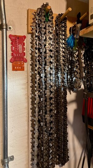

Very handy. I keep a couple on a nail near where I sort and store chains, and another where I grind.
A couple of bucks each, up to $10, depending on which one, and where you buy it from.

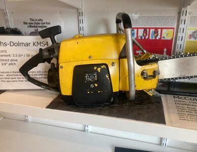

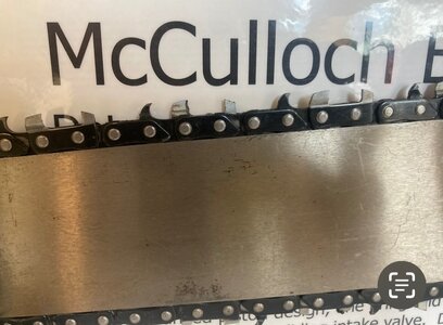

Loving the looks of that original "PowerSharp" loop!!!
Did You ever try cutting with those?
The first chainsaw I purchased (not first I used) was a corded, electric, from Sears Craftsman, with the ‘Barracuda’ chain.
Long before I knew anything about chains, sharpening, etc.
However, @heimannm schooled me that the ‘first’ PowerSharp chain came on a yellow saw, in the rarly 1960’s.

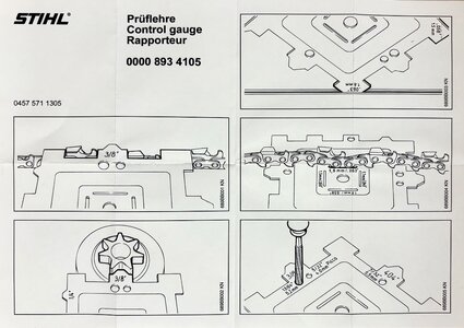

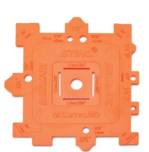

Here is the instruction sheet for the STIHL model.
One thing that it does, that the others don’t do, is it measures the pitch of the drive sprocket (presumably also the nose sprocket).
Unfortunately, it does not distinguish between full 3/8 pitch and 3/8 low profile / ‘Picco’, which would be a nice feature.
