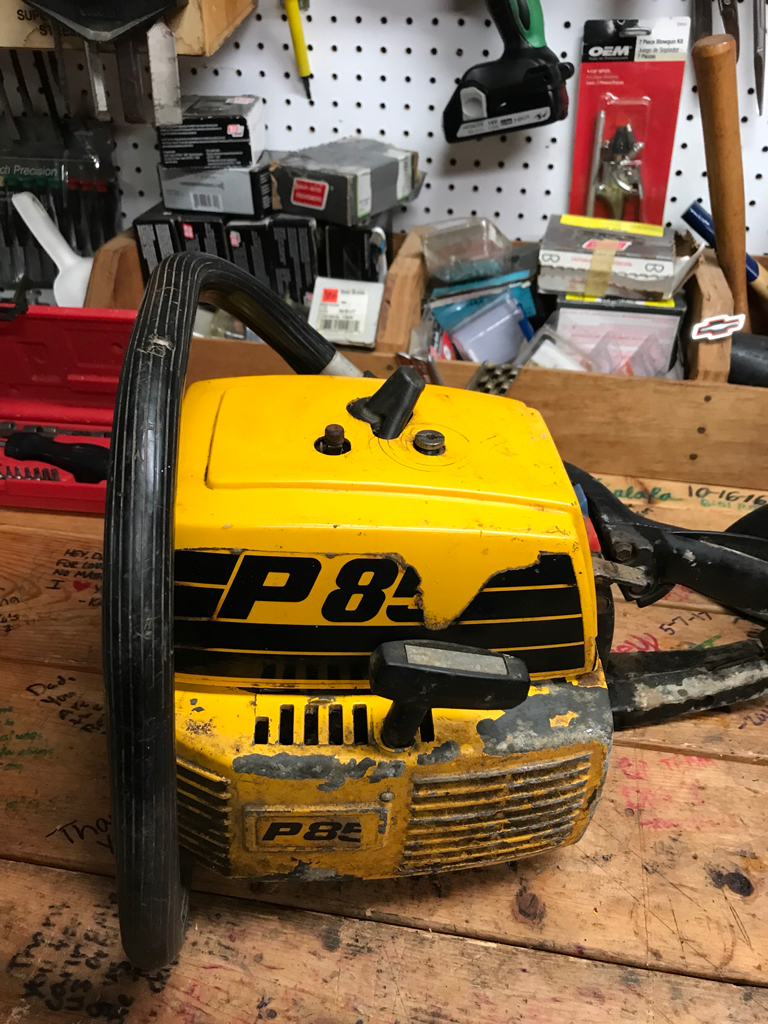

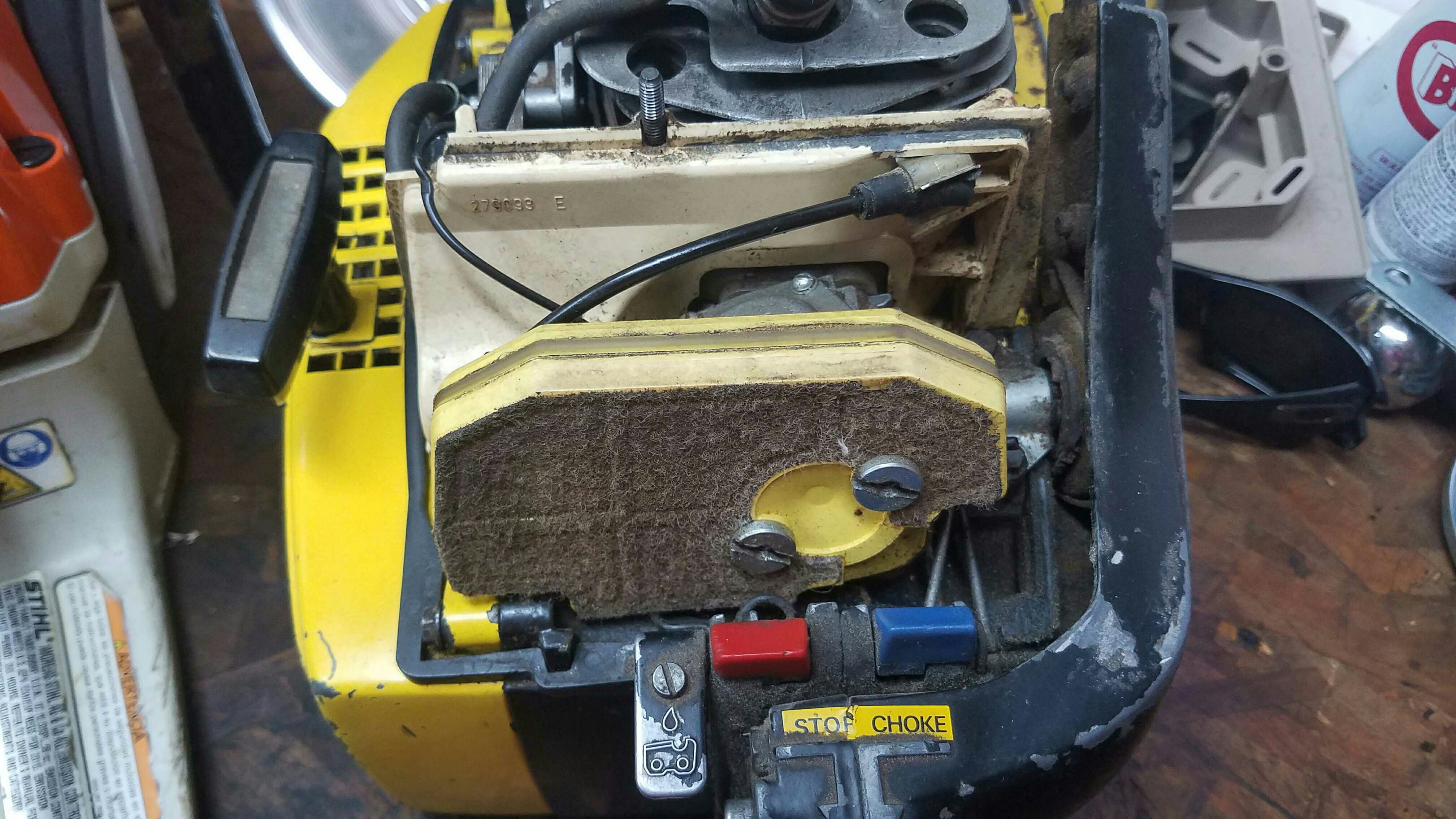

New to me P-85. Any idea where I can get an air filter setup...or does any one have s pic of what it looks like? I’d appreciate any info actually

P85, P100, And Mcculloch PM1000 should all be the same. There's a couple on ebay.
I snagged a couple of P85 parts off of flea bay for the restoration of a P100 super that seems to be a long drawn out process . These seem to me these saws are rather rare to find parts for and if and when they bring a premium has been my observation .For me it's a learning process as I've never owned nor worked on any Partner equipment ever before the two P100's I now own .
