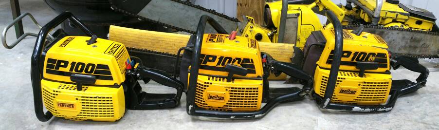

From what I see the brace on the starter side of the super is not on the regular P100 .I can only assume the brace was added to strengthen the lower handle which is pivoted from the casting on the saw which is not a very good design .My other one in McCulloch paint scheme has a broken pivot .
How about porting or piston?

I rather doubt there's any diff .I will say this from a casual observation of the cylinder .It doesn't have external flanges like most removable cylinder designs .They are cut with metal all around them from holes in the bottom of the cylinder making the point of attachment stronger than normal flanges . I'll know more once I really get into it but it appears to be very well made other then the pivot point of the lower handle .
Of late I bought a reprint of the IPL for the pm1000 saw .With Mcculloch parts numbers I have cross referenced the seals to CR .As follows FW side ,mac number 32086--cr # 5805 Clutch side ,Mac # 32087 CR # 8552 .Nothing so far on the bearings .

Group P100 photo. Took the front one out of its box.
