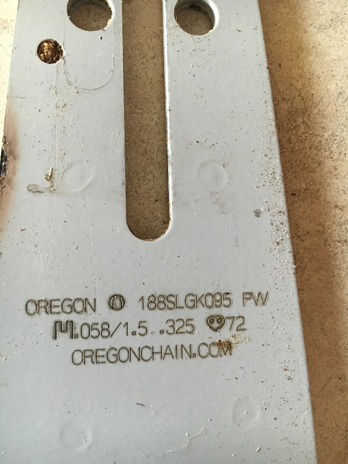

If the bars you are looking at are 188SLBK095 and 188SLGK095 then the difference is the nose. The SLB is a narrow nose profile and the SLG is the normal or wider nose. I use the 188SLG and 208SLG on a Husky 51 and like them a lot. They bore cut very well. I actually haven't seen an SLB so I don't know how much more narrow it is.

I measured my 18" SLG against the Husqvarna HL-258 narrow nose that came standard with the saw and they have the same depth of cut.
Also, I seem to have a hard time finding SLBs but SLGs seem readily available.
As far as plunging, the Husky bar has more of a difficult time entering the cut. The SLG enters the cut seamlessly. My experience is that all my narrow profile bars are difficult when starting the plunge. With my Echo cs-361p and an Oregon narrow nose bar I just can't start the plunge, but with the wider nose Echo branded bar it will bore just fine. But of course, we all have different experiences.

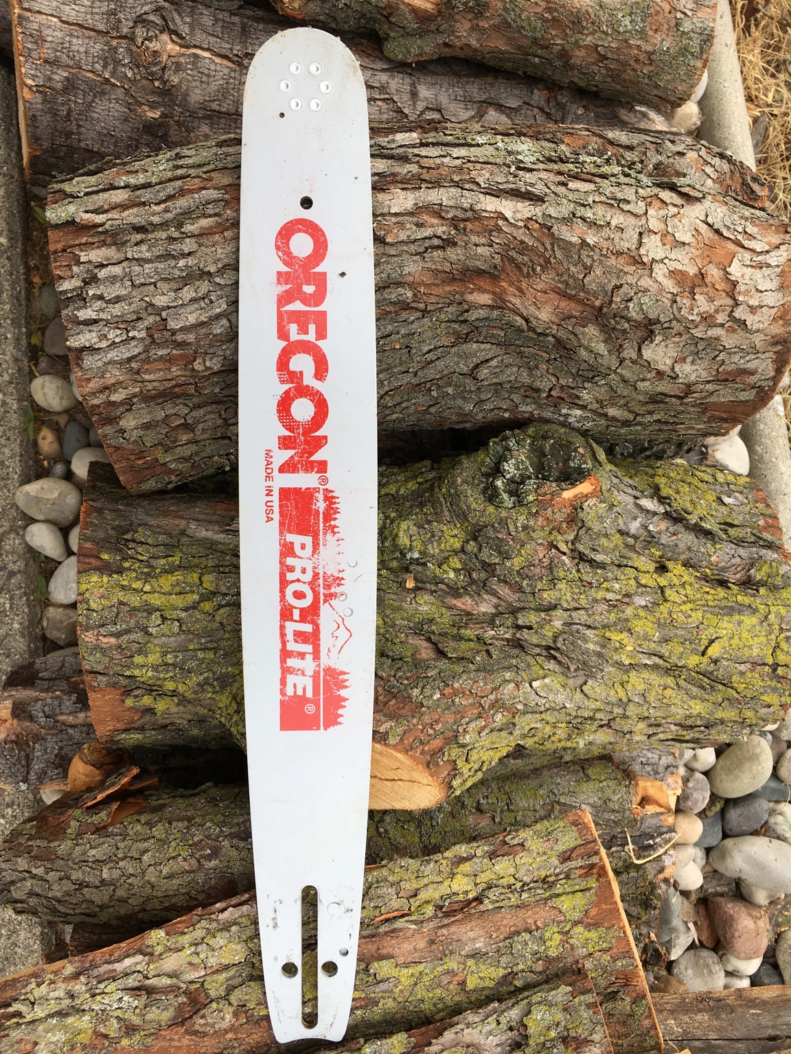

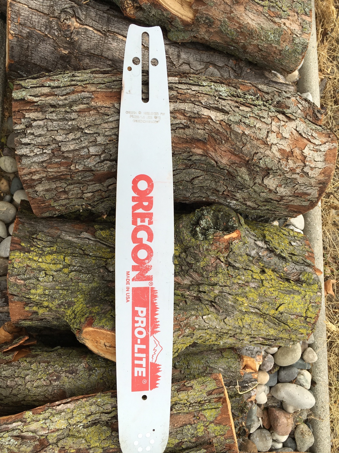

This is the one i have

Ryan if you have a "16 Stihl bar for a 201T in decent shape i'll trade you this Pro-lite bar for it. My 550 and 346 use 3/8"
