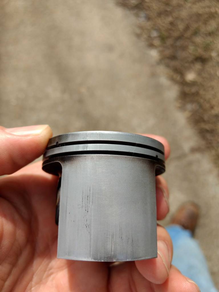

A little, can feel a couple of these with a finger nail
I need pistons just like that one. Please PM me.
I like those, if you was to drop that jug about .030
