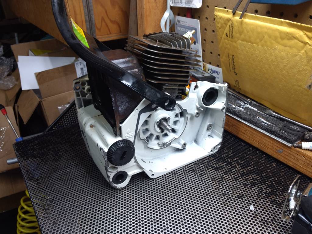

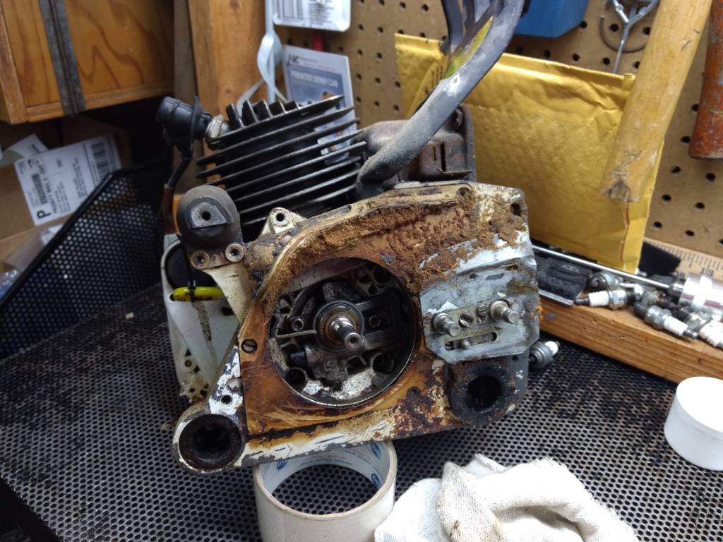

Before and after...
And yes the cylinder clean up was way easier.
How did you accomplish this feat?
tickbitintn
2:16 PM
464
Jan 9, 2016
1,897
8,016
middle tn
I block them off like you would to pressure/ vac test...
Degreaser and a soft bristle scrub bush to knock off the heavy stuff...
Rinse with hose then into the USC...
Then a quick rinse.
