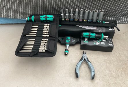

And a tad more tools came today:
All these Wera handles have a ratchet function,
one of them was grossly mispriced lol
And I couldn't resist the temptation to buy a Knipex electronic bit too, there was a 40% offer on that one.....

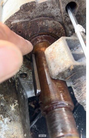

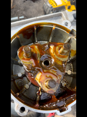

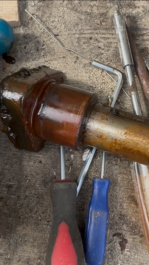

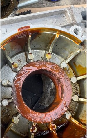

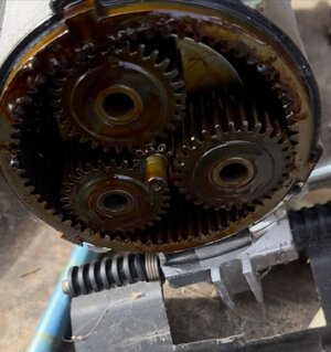

Good morning gang.
That pita of an electric shredder yesterday, I had it apart twice. Anyway I think it’s the cutter/gearbox semi seized.
So the electronics thinks it’s got a blockage and cuts the power to the motor
I couldn’t/didn’t have time to pull all the gearbox apart and it still don’t run 🤦‍♂️😴
And it’s gonna be difficult to get it all apart.
It will have to wait till the weekend now
:Edit add pic
gooder evening boys & whatnots..
I stripped the shredder in quicker time as it’s probably 4th time 🥱.
It was as i finally thought, (process of elimination). The semi seized shaft caused enough resistance, the circuitboard thought it had a blockage/jam and then cut the power to the motor.
I wirewheeled & sandedI as much as I could and then greased it up. It now works as it should . “For a homeowner shredder 😴🥱
Btw I thought you,d be wanting the dirty shaft pic's. 😉
