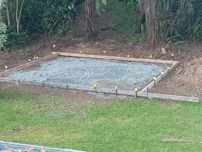

Pouring a pad??
Yeah 4 inches in your measures thick with reo mesh.👀
I need a bit more gap20 gravel first.
Shed kitset people are a bit confused because my crete guy wants to put water shedding rebates at the door positions and no one's ever asked about doing that before, but we'll work it out.

4 inches makes way more sense than 101.6 mm 😂. The taper or rebate at your doorways is definitely worth while but most people don’t think of it til they have a water problem.

Just having the same talk with Dallas. He's like why are the studs 23 5/8 apart?
Because that's 600mm you dumb kunt. And 600 is easy to multiply.

The cladding extends down past the outside edge of the slab by 3/4 inch so water drips off.
But now I'll need some ride on mower ramp trickery to get the doors to swing over that.
