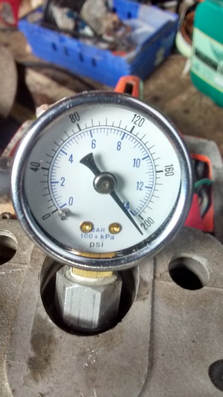

This one is a strong runner with great compression! Looks like it will clean up well... took a minute to clear up and idle. I don't think it was ran in quite awhile. But seams strong....!

The tag was gone on this saw so might not be a 288.... I'm still sure it is but any help here would be great...
hear is the cylinder #'s
IMG_3589.JPG IMG_3590.JPG IMG_3594.JPG I'lll mic out the stroke using the piston wear on the cylinder and post when I get home tonight.
