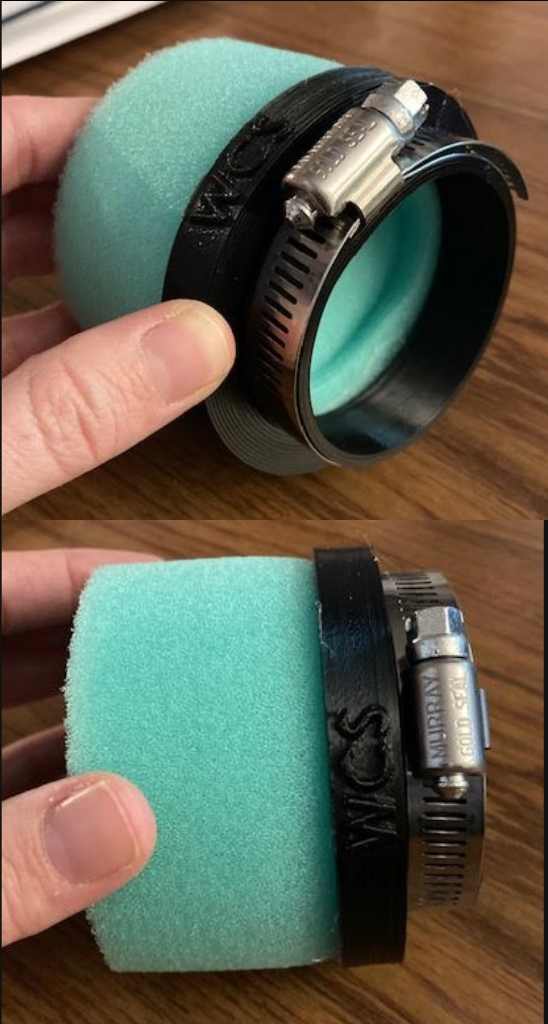

Anyone try the foam filter for this 462? Just curious to hear from anyone who has one.
https://westcoastsaw.com/products/air-cleaner-system-for-stihl®-ms462®?variant=36532614135972
I put one on mine. And defeated the air injection. Works good.

Notice any power difference or just better filtering?
It feels like I can lean on it a little harder now. I'm pretty bad about dogging in and raring up on the handle. I'd say it's comparable to the gains from a muffler mod. Combined with the mondo muffler mod it runs pretty good.
Before I got the filter and chopped the top cover, with just the muffler mod, it would run real rich and smoke until you cleared it out with a good full throttle run. And it took 7 pulls to start cold every time.
After the added airflow it starts 4th pull cold and is ready to go. Not sure whats up with that.
