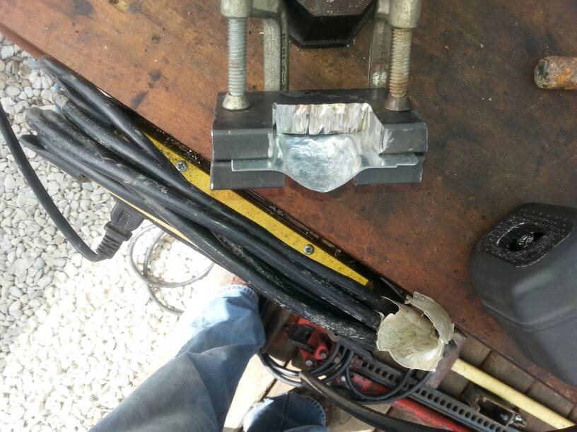

All good work on muffler mods here i was wondering how do you guys make new deflectors that wanna add a second exhaust port. I been playn around tryng to make one bit its not real pretty.
Stihl gotta work on it a bit.

Heres the jig thing i been working on and a pic of the deflector sitting on muffler.
The sheet metle is a little thicker then the muffler material so tjat dont realy help either bit thats all i had layin around. Still needs work but its a start.

I would heat up that deflector with a torch real good to burn the galvanizing off because you can get really sick from it when it gets hot. The galvanizing will smoke and cause metal fumes fever. Just be careful using that stuff with heat.

Agreed! You can also grind off the galvanized coating where it will be welded. Galvanized sickness sucks! It seems very weird but if you do start to feel sick drink lots of milk.... it helps!

Not gonna use it. Im just playing to see if i could make one. Gonna go get a small sheet fromm weld shop. I need thinner stuff any how.

Ya its a peace of divider out of a cabinet from work Lol
just be careful when you work with galvanized stuff, I know one lad who lost all his amalgam tooth fillings, cost him about 8000$ in dentist bill.
We perform metallization at work, required fresh air mask, has been a few people who has taking the easy route and used normal mask, and paid the price with sink polution.

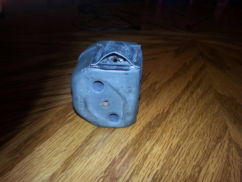

Echo exhaust?
bikemike
12:15 PM
768
Feb 4, 2016
2,263
5,438
Cottage grove mn
Yep echo. Those are very expensive mufflers new or used. That's why I spent a Lil more and piped my echo

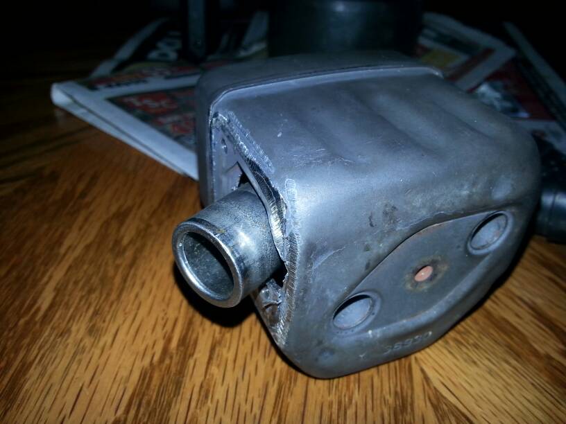

Not anymore I don't but I cut mine in half gutted the baffle out and installed a bigger diameter tube in it. Ran real nice. This is the muffler mod now on my cs 510 49cc20160325_185645.jpg
