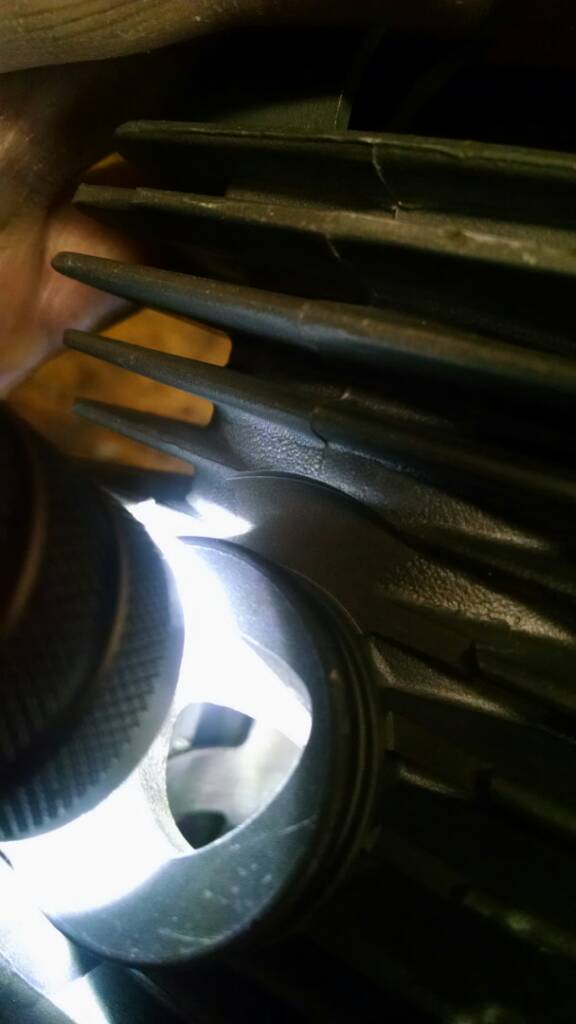

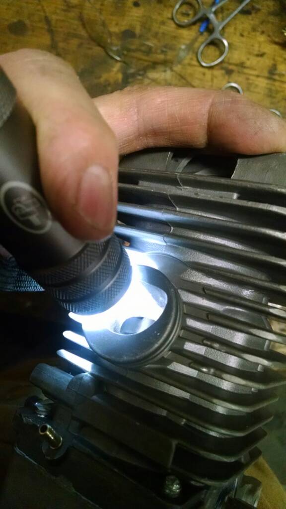

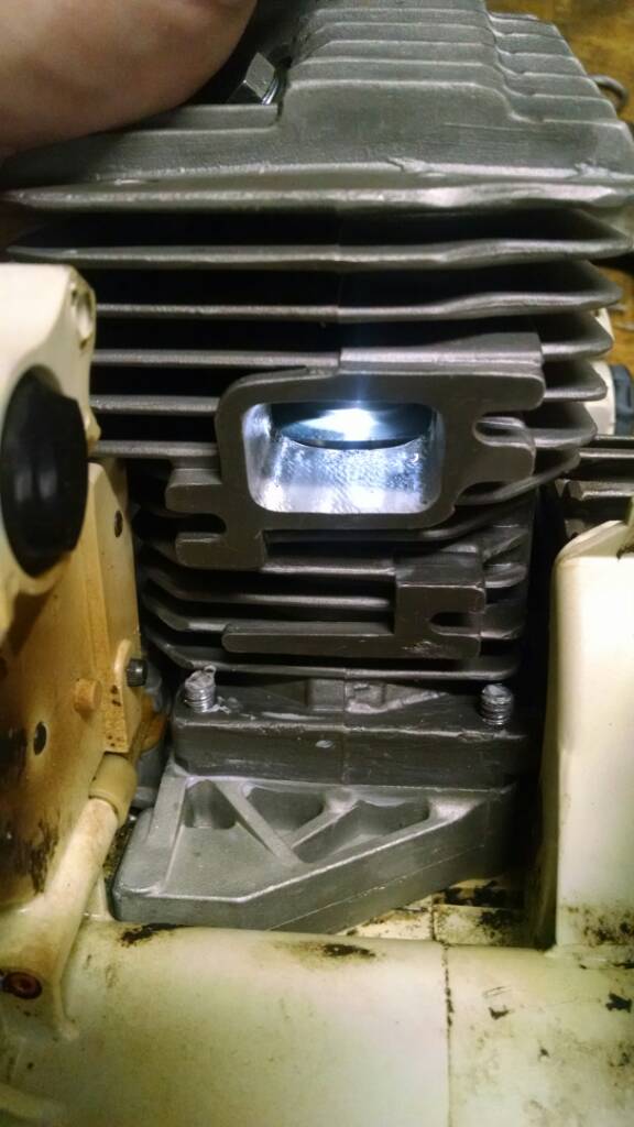

Started rebuilding the 310 today with a Hyway cylinder and the Cross piston.
The cylinder looks quite nice and is a closed port variation. Squish was right at .029 and the port heights measured the same as the stock 310 cylinder.
I'll get some timing numbers tomorrow before it goes back together. Just cleaned up the ports a little on the Hyway, no widening.

Pics of the closed port cylinder?
beaglebriar
The Peanut Gallery
4:59 PM
377
19,611
113,075
Warren Center, PA
Lol My buddy that has built several of these asked for pics also. Hell I thought all the 390's were like the Hyway cylinder.
I don't remember to take pics while I'm working. Here's the best I can do..
