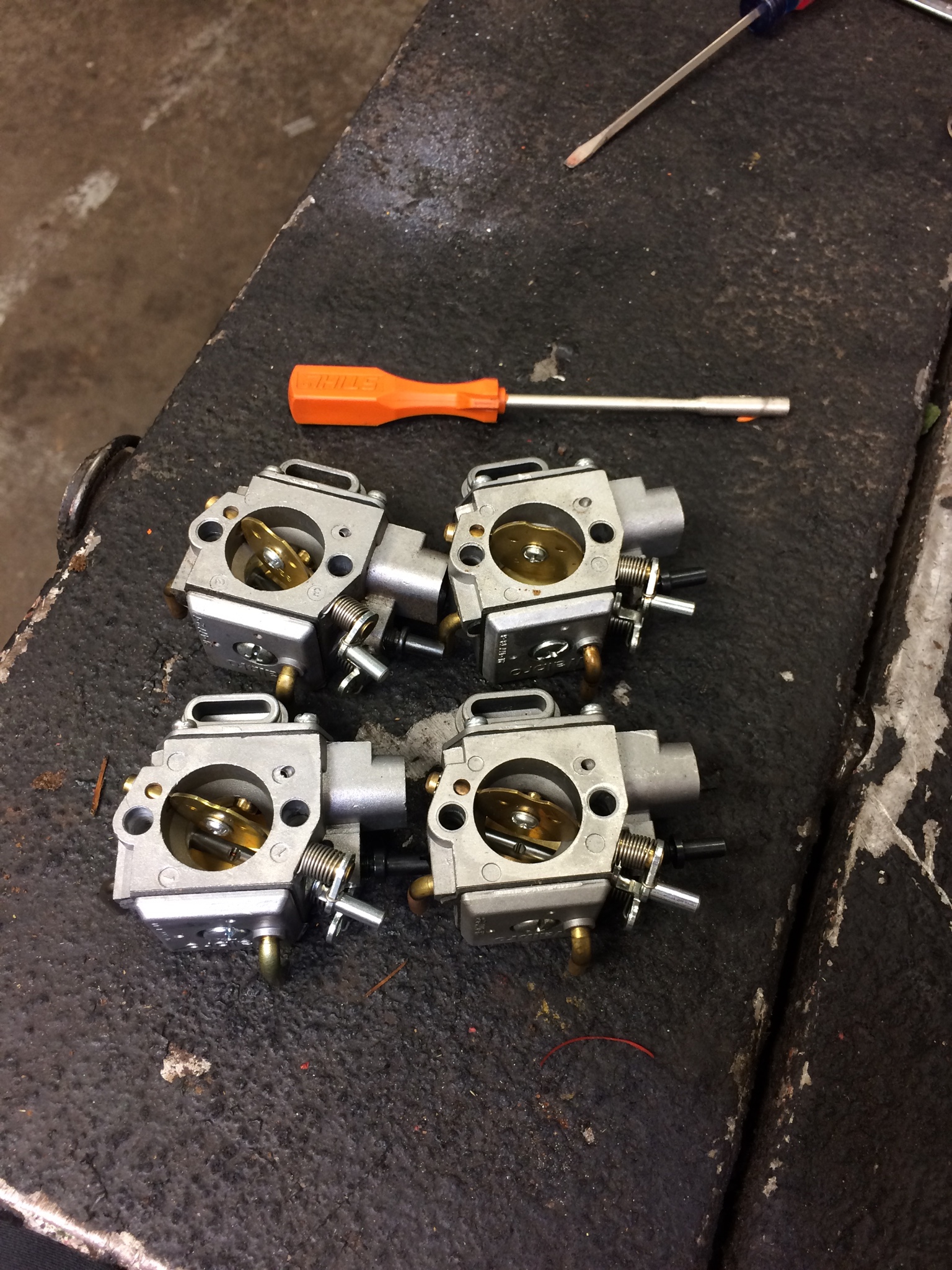

If you don't want to go through the process of grafting a 660 carb on the saw, you can mod the existing carb to get the same torque and throttle response.
If you don't want to go through the whole process of blocking off the EPA circuit, you can just drill the auxiliary jet in the low speed circuit. You will need a set of micro-drills and a pin vise to do it.
I think I took mine out to .35mm, but I had also blocked off the EPA circuit.
If you had two carbs to work on you can be more confident that you got the right size jet. Stock size is .25mm - take one of the carbs out to .3mm and the other out to .35mm. Test and compare. If the .35mm works better, then take the .3mm carb out to .4mm and test again.

There seems to be a lack of interest in modding carbs. People just swap a carb, get an improvement and call it good.
This would be a good project for the forum, modding an HD for more power. There are plenty of other saws that use the HD and the concepts could be applied to those other saws.
