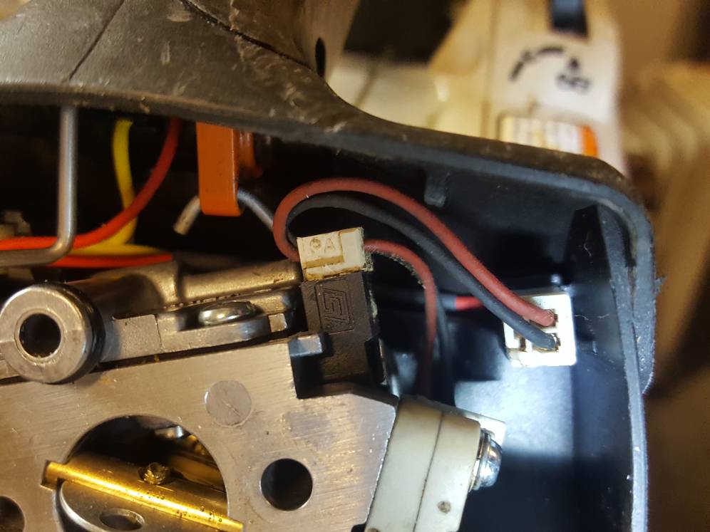

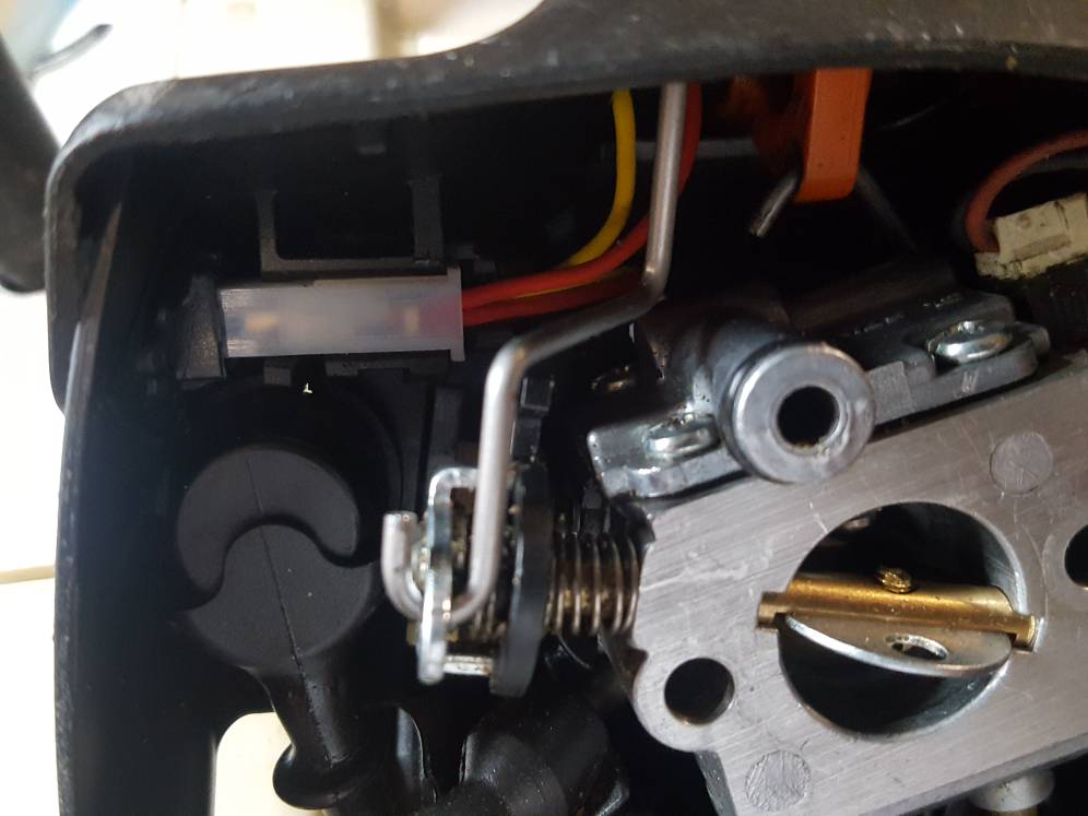

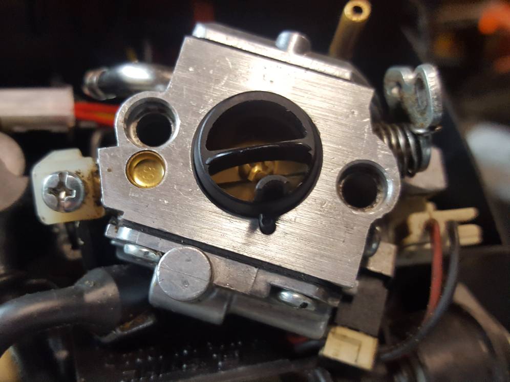

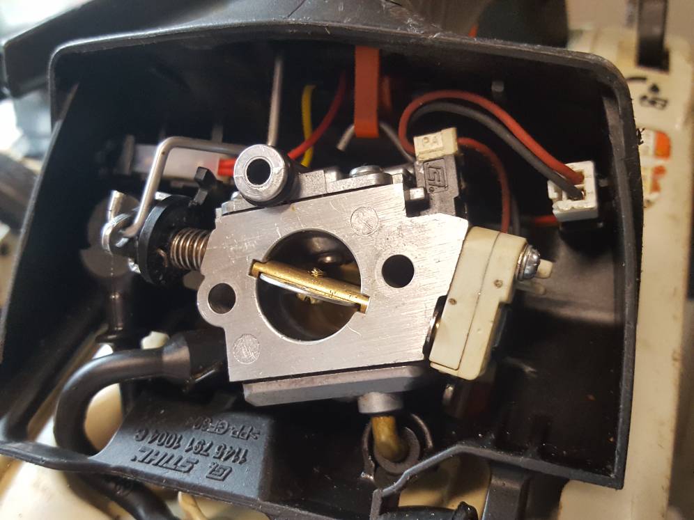

So a box was in the mailbox today from @redlight066. In it was this handy bit that fits nicely in the carb.
Jimmy in NC
11:47 PM
57
Dec 23, 2015
2,017
8,063
North Carolina

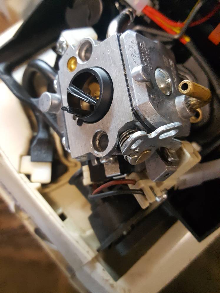

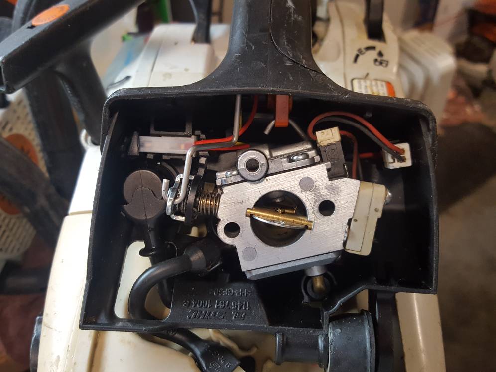

I popped some pictures of the wiring and how it tucks in the carb box for any of you that are curious or for future reference. The carburetor disconnect slides out as a whole and does NOT have to be disconnected in the carburetor box. Everything has a place and tucks out of the way nicely.

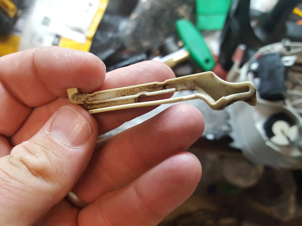

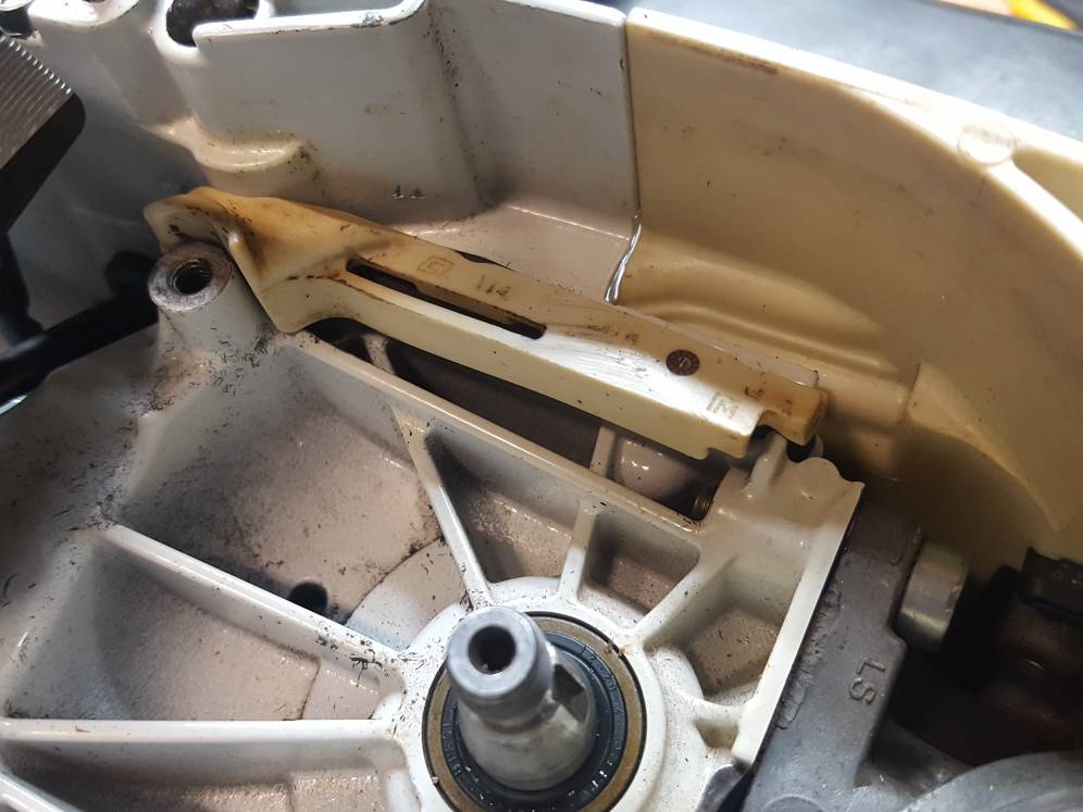

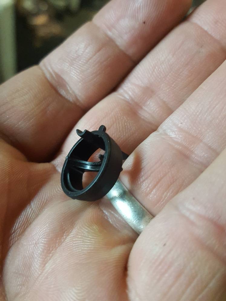

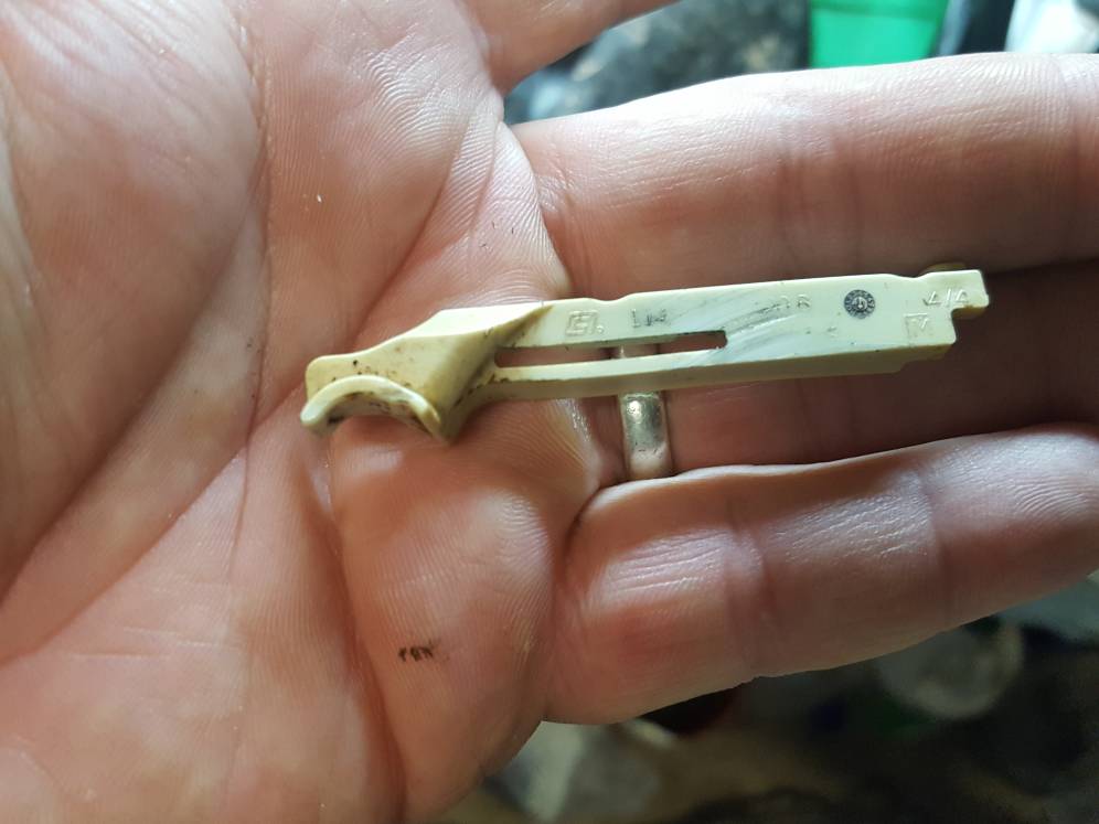

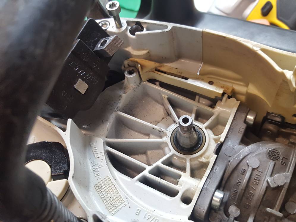

So this little piece came also. It appears that it is to ensure there is no flywheel / high tension lead interaction. I do not see how to make it fit in these cases though. It may be due to the heat shrink repair, but I do not see how to make it fit by the coil bosses either. Either way it will not fit currently. I also noticed there is a slight rub still on the coil lead. Right now that is as good as it gets with out major coil surgery or replacement. I was quoted 139.99 for the coil so for now we run it and ensure everything else is okay. IF it fails again, I will address it then. It may clearance a bit of heat shrink and be good...time will tell.

wish I had a better solution for the spark plug lead. This saw is so tight everything has to be just so. I may be able to splice it where it goes behind the coil...maybe.
Can you make the slot the lead is in a little deeper?
Nutball
10:47 PM
7732
Oct 31, 2018
4,293
11,873
Mt. Juliet, TN
I didn't think the flywheel wore down to bare wire, so I was thinking just cut off the heat shrink and use the plastic piece.
If you look at the pictures it doesn't even fit with the coil removed... the cases are physically different I think by the coil mounting boss.
