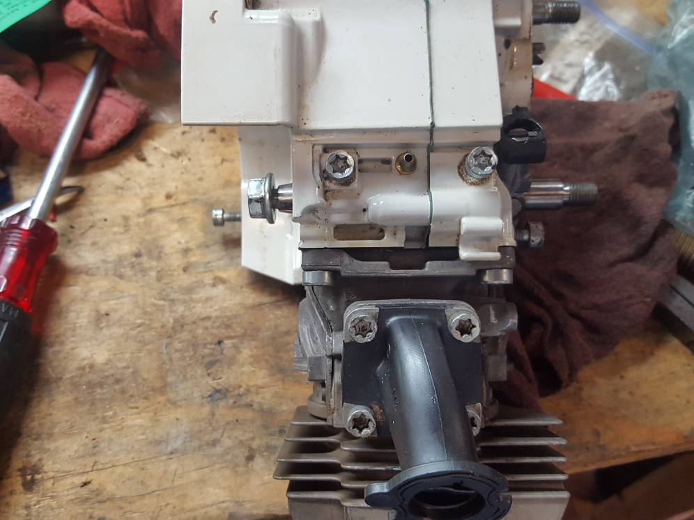

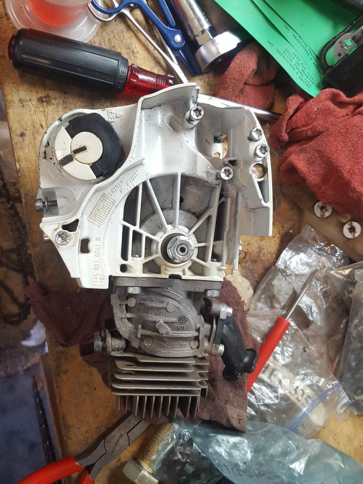

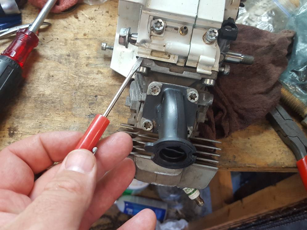

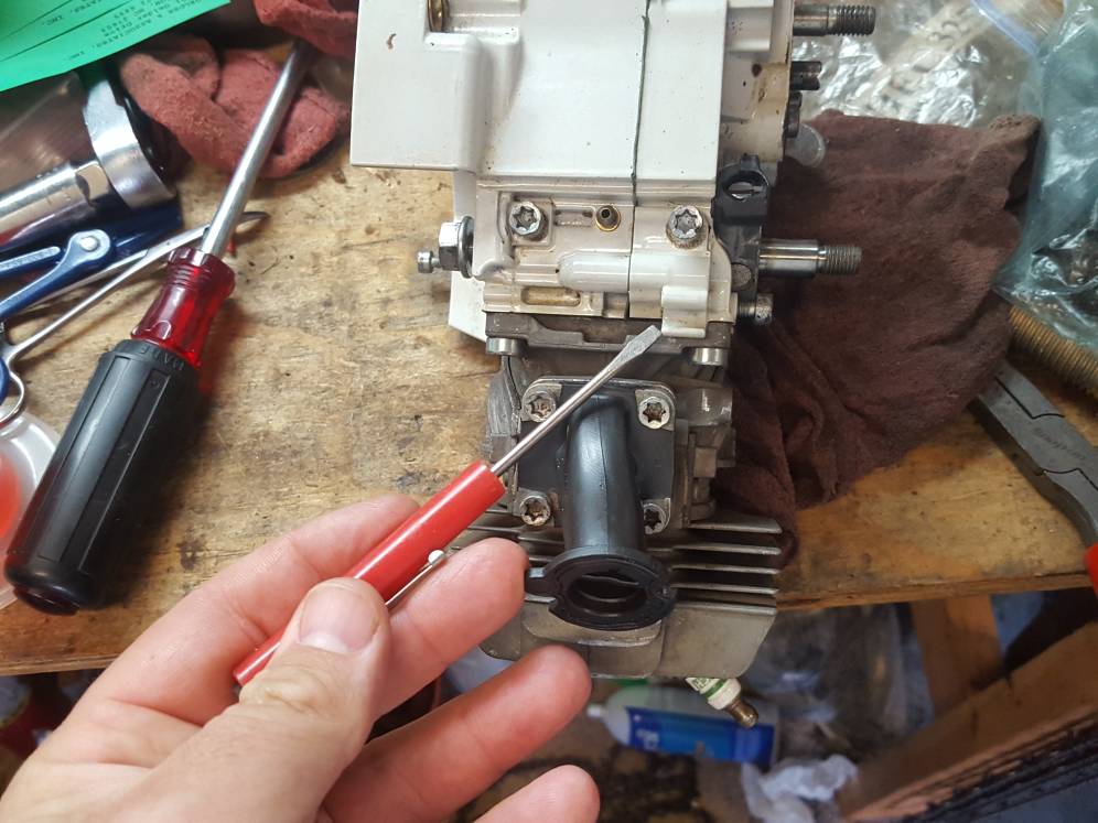

Anyone wanting to know why its such a big deal about swapping these coils...its not just price. This is how far the saw has to be apart to replace a coil. The areas pointed at by the screw driver are high tension lead holders that are only accessible with the fuel tank removed.
